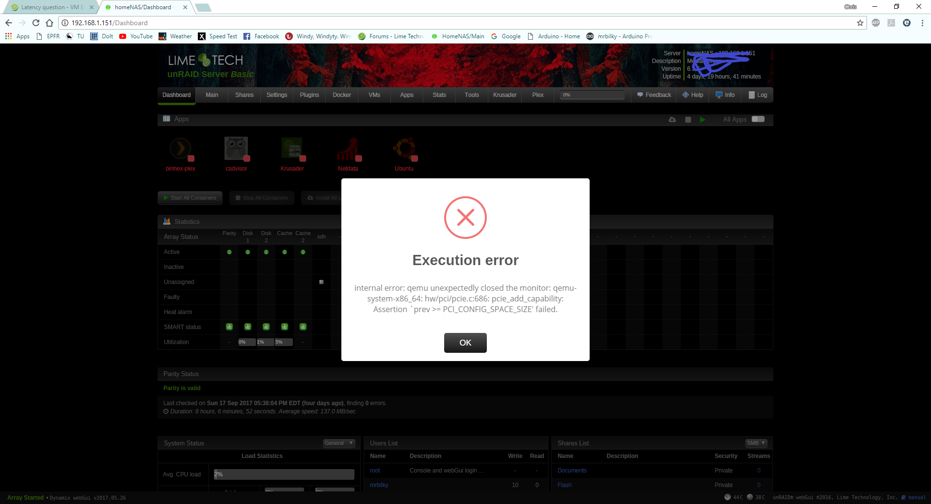

server HP envy pre-built i7 6700 16 gigs of ddr4 ram 5 drives 1 parity 2 4TB hdd 2 240 gig ssd using the igpu running on an R7 1800x x370 chipset 16 gigs of ddr4 gtx1080 gpu it is set to VNC tried to set it to igpu but gave me this error
Ubuntu QEMU Log.html
