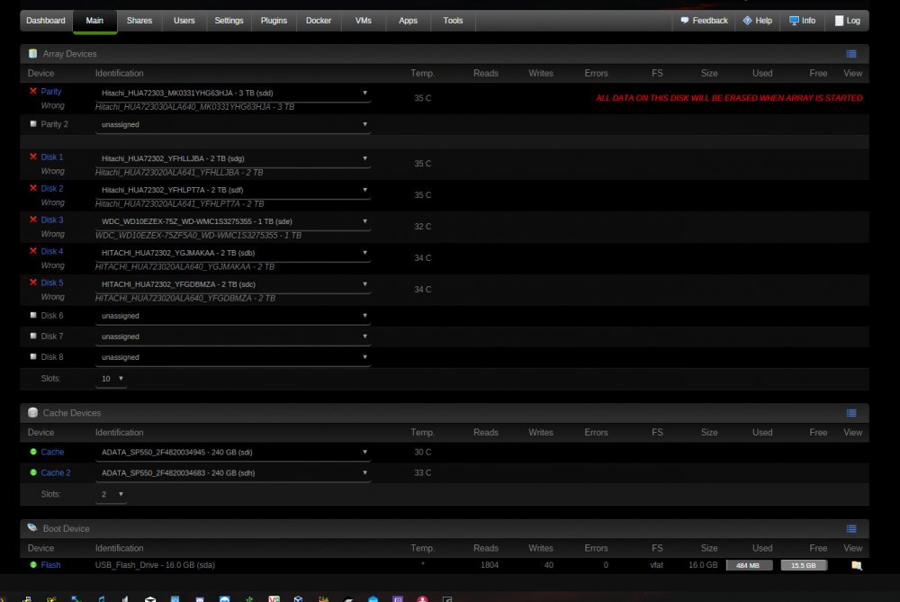

September 22, 20179 yr Within the last year I upgraded from using an old am3 motherboard to an dual xeon board with practically no problems other than a few sata ports not working which was no big deal at the time as I didn't need the ports. A few months ago, however, I added more drives and needed more sata ports, and thus added a cheap realtek raid card. It worked ok, but would bottleneck my system terribly whenever I was transferring from share to share within the server. Last week I decided to upgrade and added a Dell Poweredge H310 controller card with 2 sas breakout cables. The thought was that if all the drives were handled through the same device it would eliminate any bottlenecks when transferring from share to share (or drive to drive). The card seems to work fine but seems to have changed the drive names so that now unraid doesn't read them as being the same devices (see picture). For now I can switch back to using the onboard sata ports so I can get back to running my server, but I would really like to use my new card. What do I need to do or change to migrate from onboard sata to the h310 card? Thanks in advanced! -Andrew

September 23, 20179 yr Author Ok I see what you're saying, but I guess I didn't paint the whole picture. I know what drive went where. If you look at the picture I provided you can see how the drives were originally labeled compared to what the hba labeled them. I knew it would wipe the parity and keep everything else, but it wouldn't even let me start the array. That's why I was so confused.
September 23, 20179 yr I believe that the new card is naming the drives "correctly" (i.e., compatible with the way most controller and MBs would name the drives). This is super easy to fix. You need to do a new config, assign the disks to the proper slots (including parity and data disks), indicate to trust parity, and start the array. Make sure all of your drives mount. You could do a non-correcting parity check for a few minutes and make sure not parity errors (if you left off a drive the parity errors would be enormous in seconds, if it goes a minute with none you should be fine). I have an Areca controller that also names drives weirdly. There is a plugin called "Dynamix SCSIDevices" that fixes it for that controller.. It may also work for yours, but I'd experiment, and if it is naming disks weirdly, might suggest avoiding that controller for array disks.
