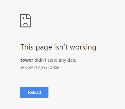

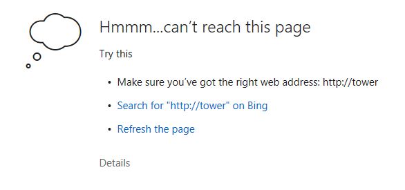

First off let me start with that I know this is not an issue with unRAID, but rather related to the computer I'm trying to use to access the webgui. However, I've been unable to solve the problem on my own so here I am...
Whenever I try to access the unRAID webgui, I get the login prompt but after entering my credentials the page does not load. The issue is not related to any particular browser. Firefox simple leaves me with a blank tab, while Chrome and Edge and give me the following.
chrome.JPG.dc47b830df86e04a798c06a556005e4c.JPGedge.JPG.71517aabed08df6b422dfc7e9d765d2a.JPG
Now some observations:
1. I know this isn't related to the VPN I use to connect into my home network, as the problem persists even when I am at home connected to my LAN.
2. I know unRAID isn't the culprit, because I get a similar error when trying to access my router's webgui.
3. I know its related specifically to the computers I am using (Windows 10 OS), because I can access the webgui just fine from other computers.
Any recommendations on how to fix this would be greatly appreciated. I've tried just about everything short of a fresh install of Windows.

So I found the root issue of my problem. Like I suspected it wasn't related to unRAID at all. It was a recent update to Bitdefender that did it. However, I haven't figure out how to solve the problem other than uninstalling BD since I am using the free version and it doesn't really let you change much.
