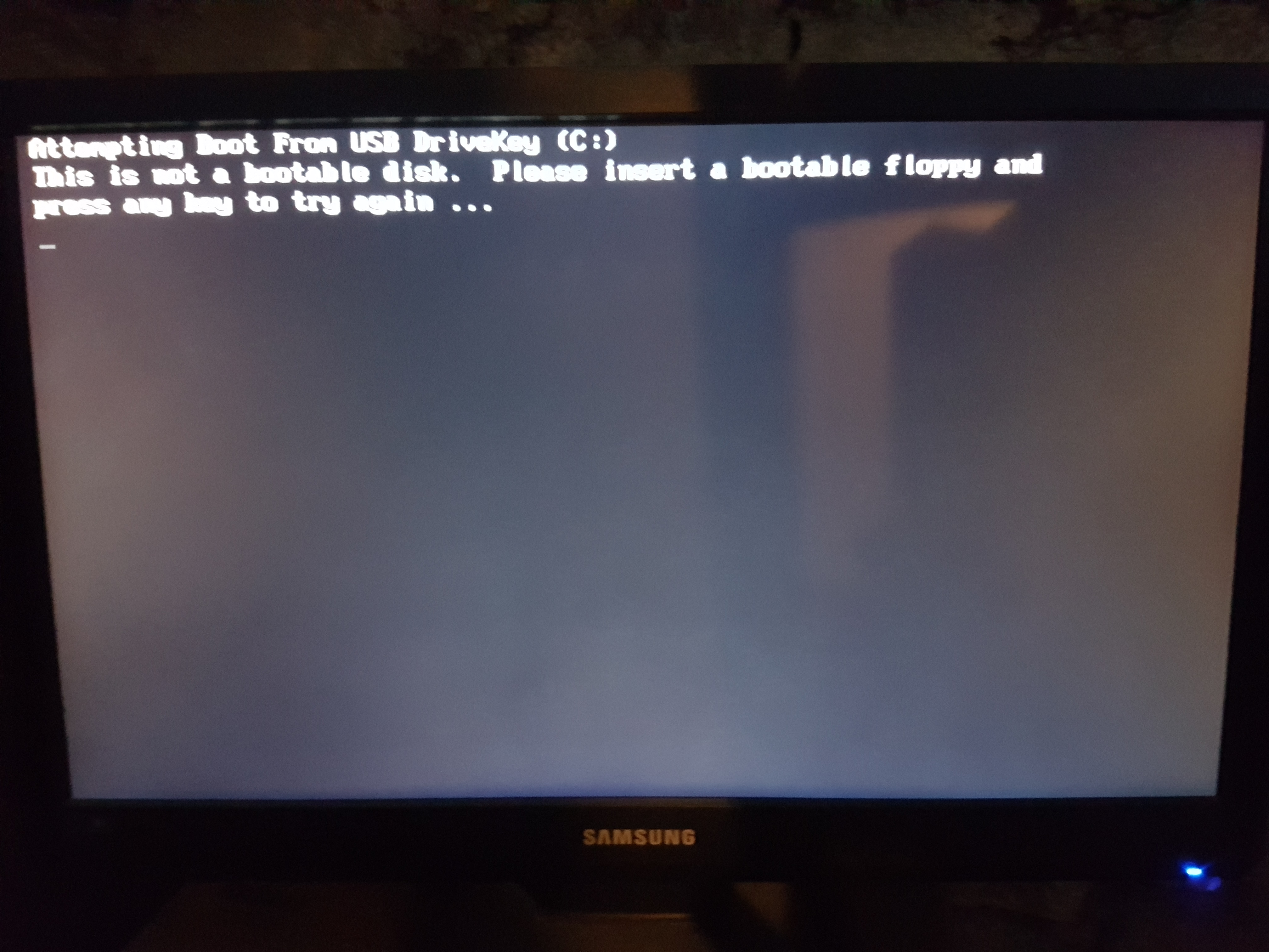

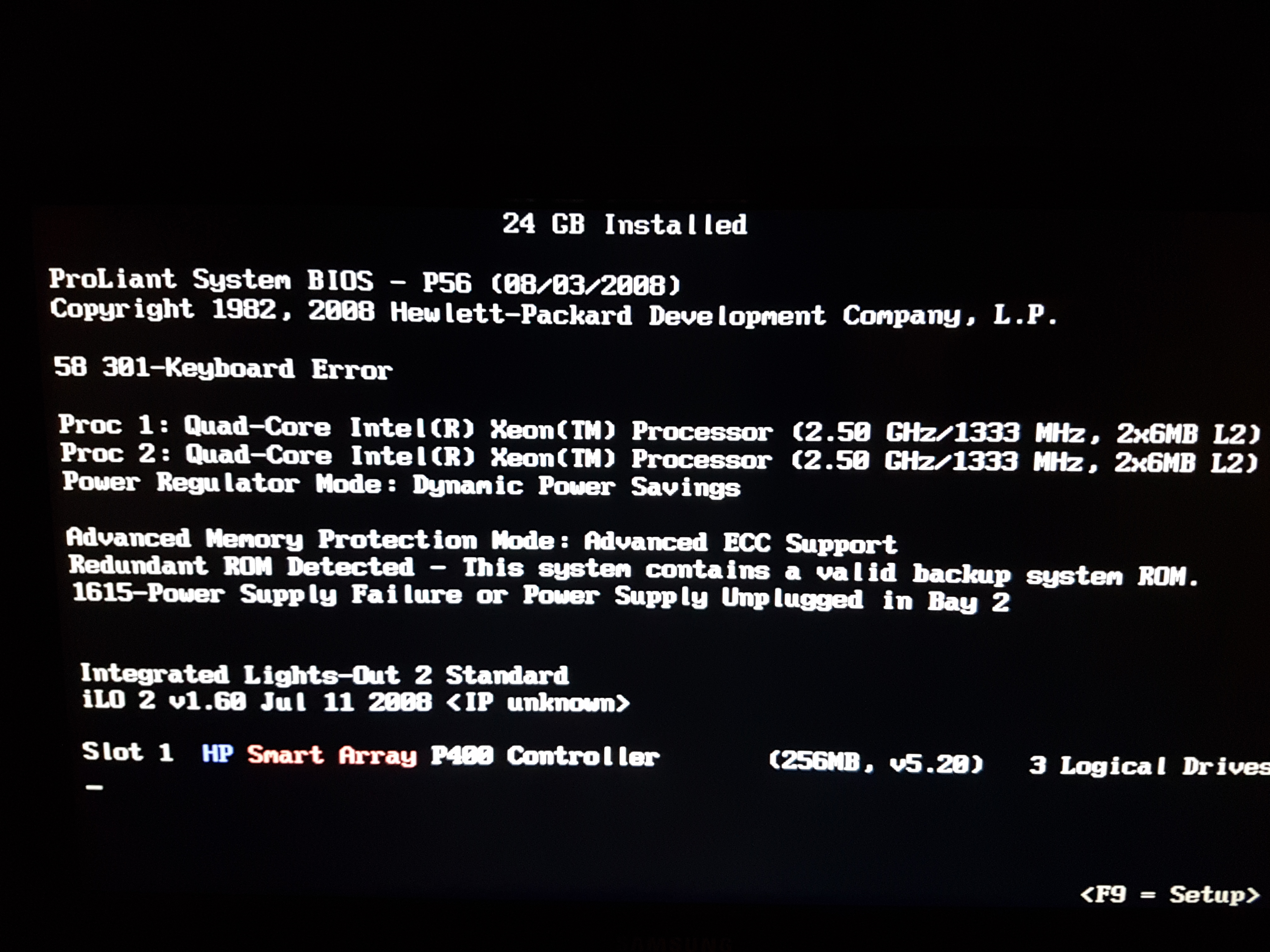

October 13, 20179 yr Hey, I wanted to try out, if unRAID would run on my server. I prepared the bootable USB with the installation tool and after it finished, I wntad to boot it on my server. After the normal boot sequence it tried to boot off the USB but it said the USB was not bootable. Now i´m a bit frutrated and wanted to know if ths is a common problem or if it could hang together with my hardware. Thanks in Advance Luis Stepp
October 13, 20179 yr Put the usb file in your computer. On the flash you should see a file called make_bootable.bat run that. Then put it back in your server and boot it and see if that fixes it. Edited October 13, 20179 yr by gridrunner
October 13, 20179 yr It appears you've set the boot device to be a Usb floppy. Usually it's set in the BIOS as a Usb hard drive. Can you manually select the flash from the on the fly boot order (f12?)
October 14, 20179 yr Author First thank you very much for the quick reply, @Squid In my boot order the USB is the first one.. Also this Server doesn´t ever had an floopy reader.. @gridrunner Yout tip actually helped , even if I now ask myself why they didn´t implemented this in the preperation tool.. Thank you both very much Luis Stepp
