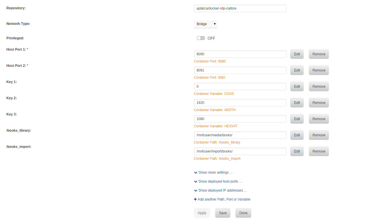

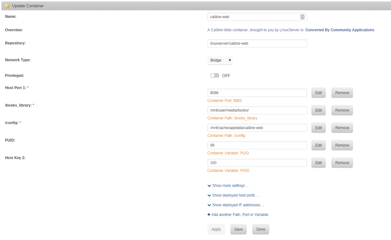

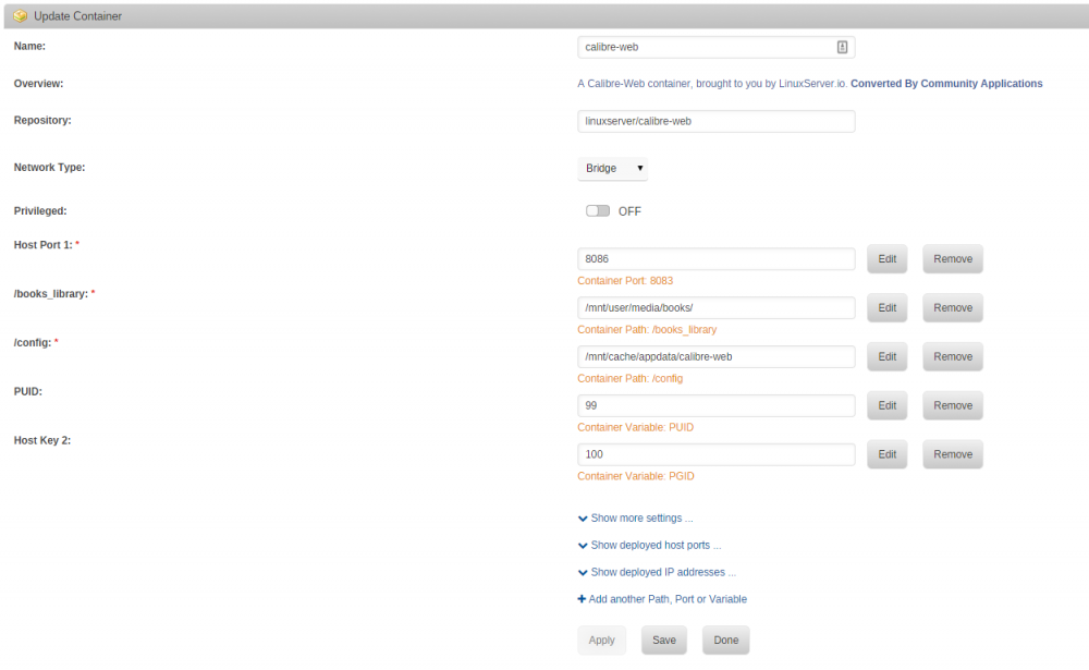

October 16, 20179 yr Here's my setup: LL to download books and books are left in an import folder for Calibre to import and LL shares the Calibre library RDP-Calibre imports the books and I use to tidy-up metadata etc calibre-web is a very nice front-end to download and browse books and allows multiple users to track their reading progress e.g. I've created accounts for my kids, family and friends. calibre-web is accessible via the web via LE, so no need to open a port. Very easy one-time setup and it's working well for me. I don't find sending via the amazon address a problem - although I can appreciate there might be privacy concerns. #calibre-web location /books { proxy_bind $server_addr; proxy_pass http://172.30.12.2:8086; proxy_set_header Host $http_host; proxy_set_header X-Forwarded-For $proxy_add_x_forwarded_for; proxy_set_header X-Scheme $scheme; proxy_set_header X-Script-Name /books; }

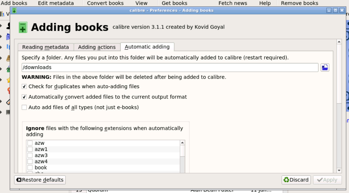

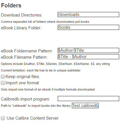

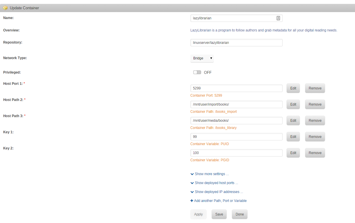

February 4, 20188 yr Author finally got around to implementing this stuff. I'd like to add a couple of setup things, and please correct me if I'm off base. Lazylibrarian does not do the calibredb importing, that's done automatically in the RDP-Calibre docker. Lazylibrarian does have access to some downloads-import forlder, in my case /mnt/user/downloads/books > /downloads Go into RDP-Calibre GUI, Add Books > Control the Adding of Books > Automatic Adding (tab) RDP-Calibre has access to /mnt/user/downloads/books > /downloads /mnt/user/calibre > /calibre-library I still feel like emailing mobi's through kindle.com isn't the wisest thing to do! So I'll also install calibre-web and get them over via Experimental Browser. Thanks again @DZMM
February 6, 20188 yr Author well, maybe I spoke too soon here for "it's all working." I see in LL > Settings > Processing it's got a few fields in there. When LL finds something via usenet or torrents, it will send it over to SAB or Transmission (torrent client). But Transmission doesn't support labels. So, they will go to the default download directory. Torrent client handles other stuff other than books! So, how would I setup that post-processing bit?
