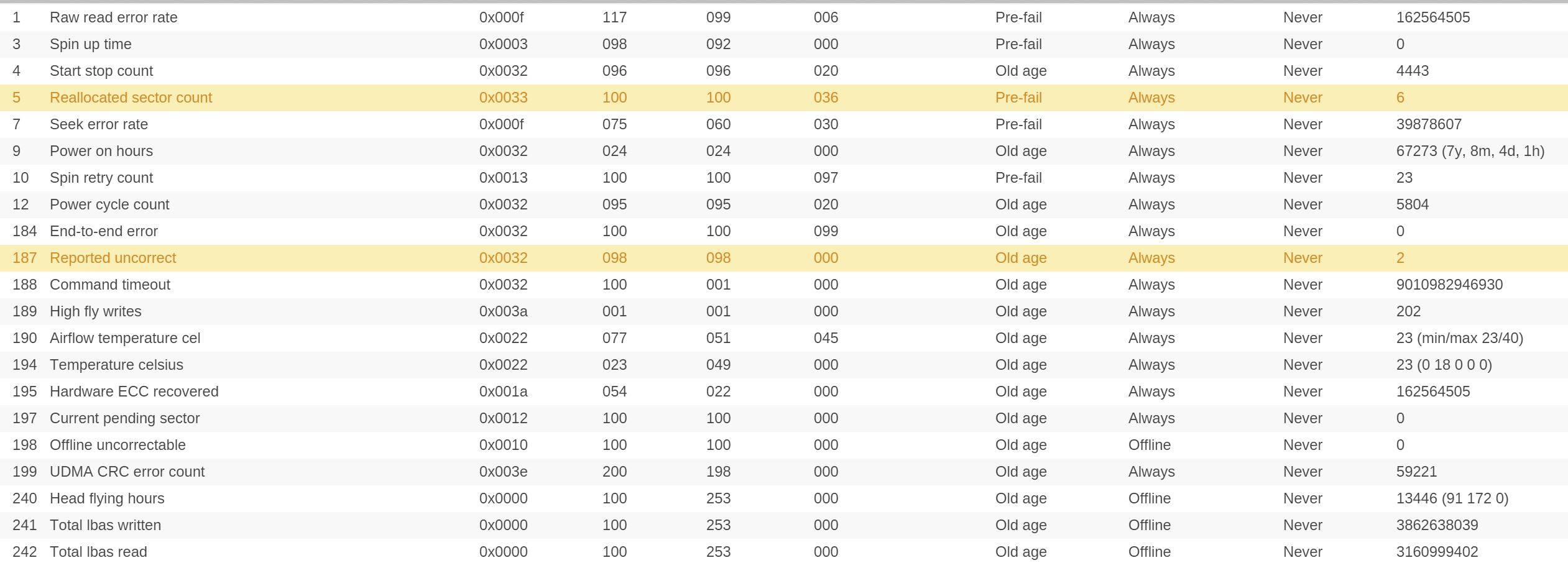

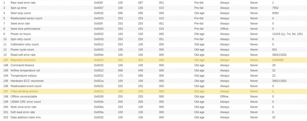

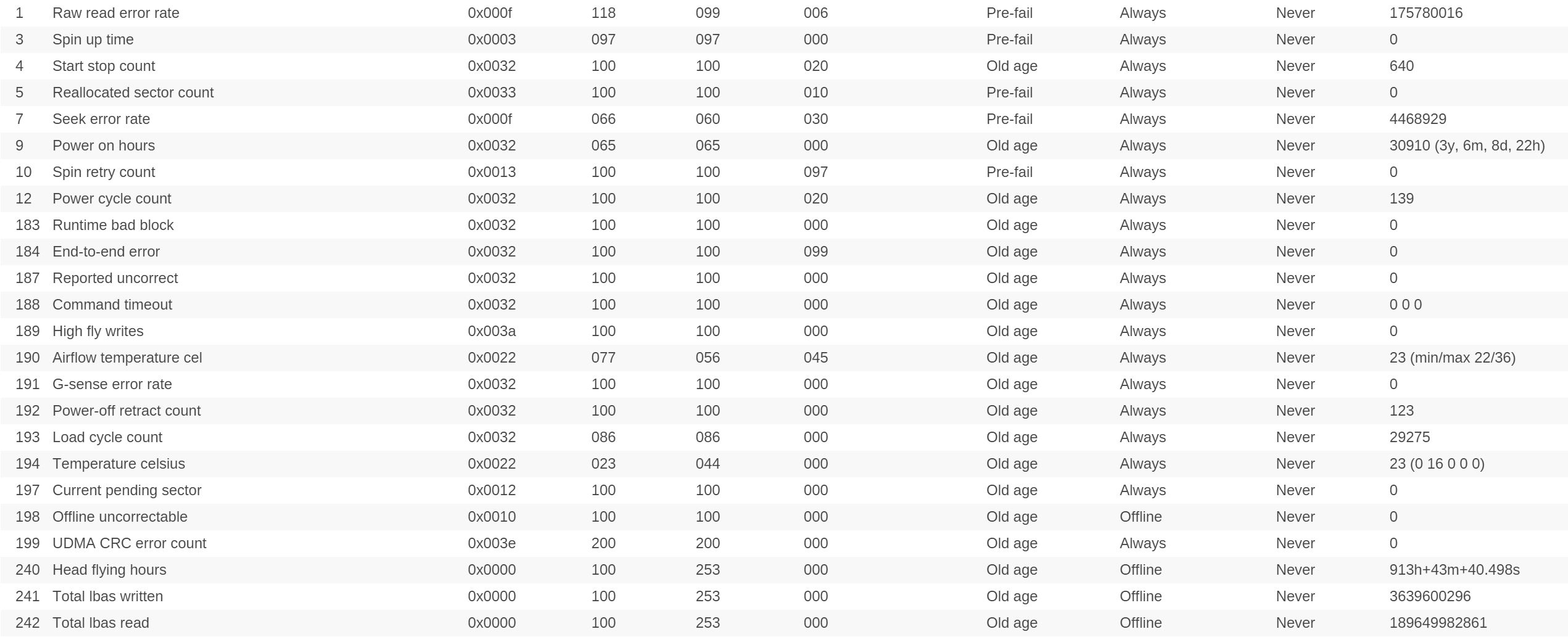

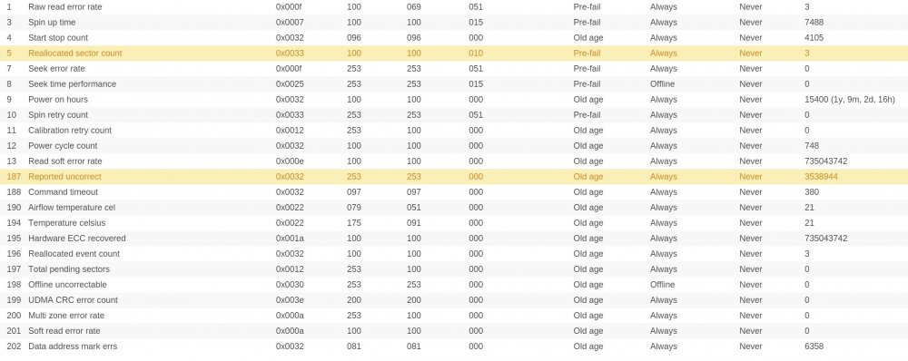

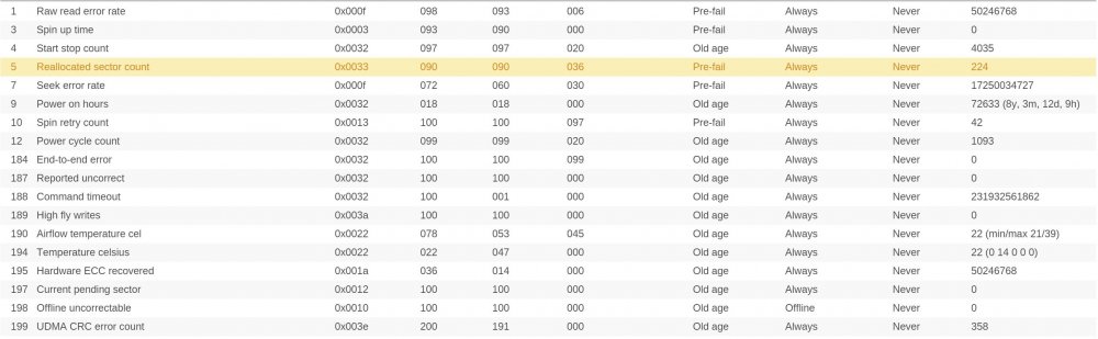

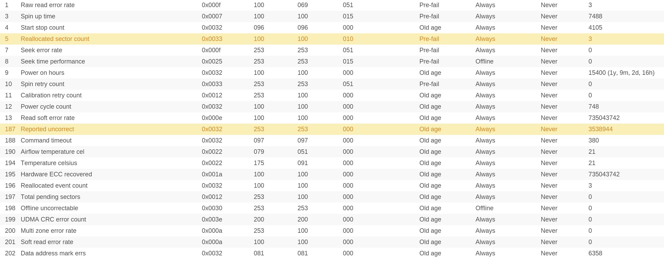

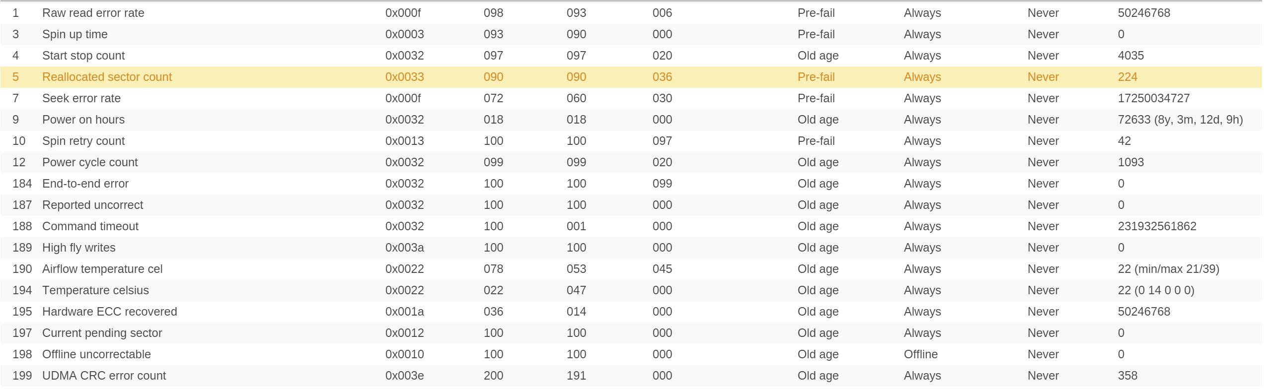

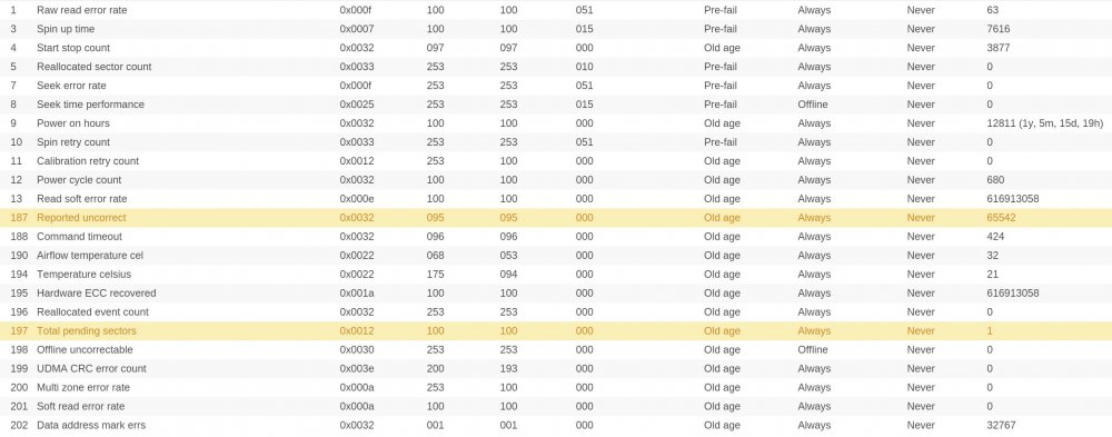

October 15, 20179 yr Hi, my server has been running over 8 years without any big issues. Now the disks seem tired of. Ther SMART reports don't look good on four of the six drives. Have a look please. Now, the problem arised, becaused sync errors started to show up. They are here every time when i run parity check. Last time it completed with 100 of errors, earlier with 26 errors etc. I ran reiserfsck on filesystems. Only one drive had problem, but was fixed using fix-fixable option. I know i have to replace faulty drives (with high allocated sector number, or report uncorrect number). I just have one question. How can i be sure that all of my files are OK if there are constantly sync errors. Is it even possible?
October 15, 20179 yr 1 hour ago, Koperfild said: How can i be sure that all of my files are OK if there are constantly sync errors. Is it even possible? Only if you have checksums for your files or use btrfs. Do you have notifications enable? You should have noticed those issues before they were on so many disks. Edited October 15, 20179 yr by johnnie.black
October 15, 20179 yr Author 45 minutes ago, johnnie.black said: Do you have notifications enable? You should have noticed those issues before they were on so many disks. Unfortunately not. Do you think that all disks except the secon one should be replaced? How high number for "reported uncorrect" is bad? So it seems i can't make sure the files are OK. Some of them may probably be bit-rootten? I think i will replace faulty drives and create new setup using btrfs...
October 15, 20179 yr The most critical are the ones with current pending sectors, you should run an extended SMART test on all disks, sometimes pending sectors are false positives, but if 2 or more disks fail the test there will be some loss of data during the replacement.
