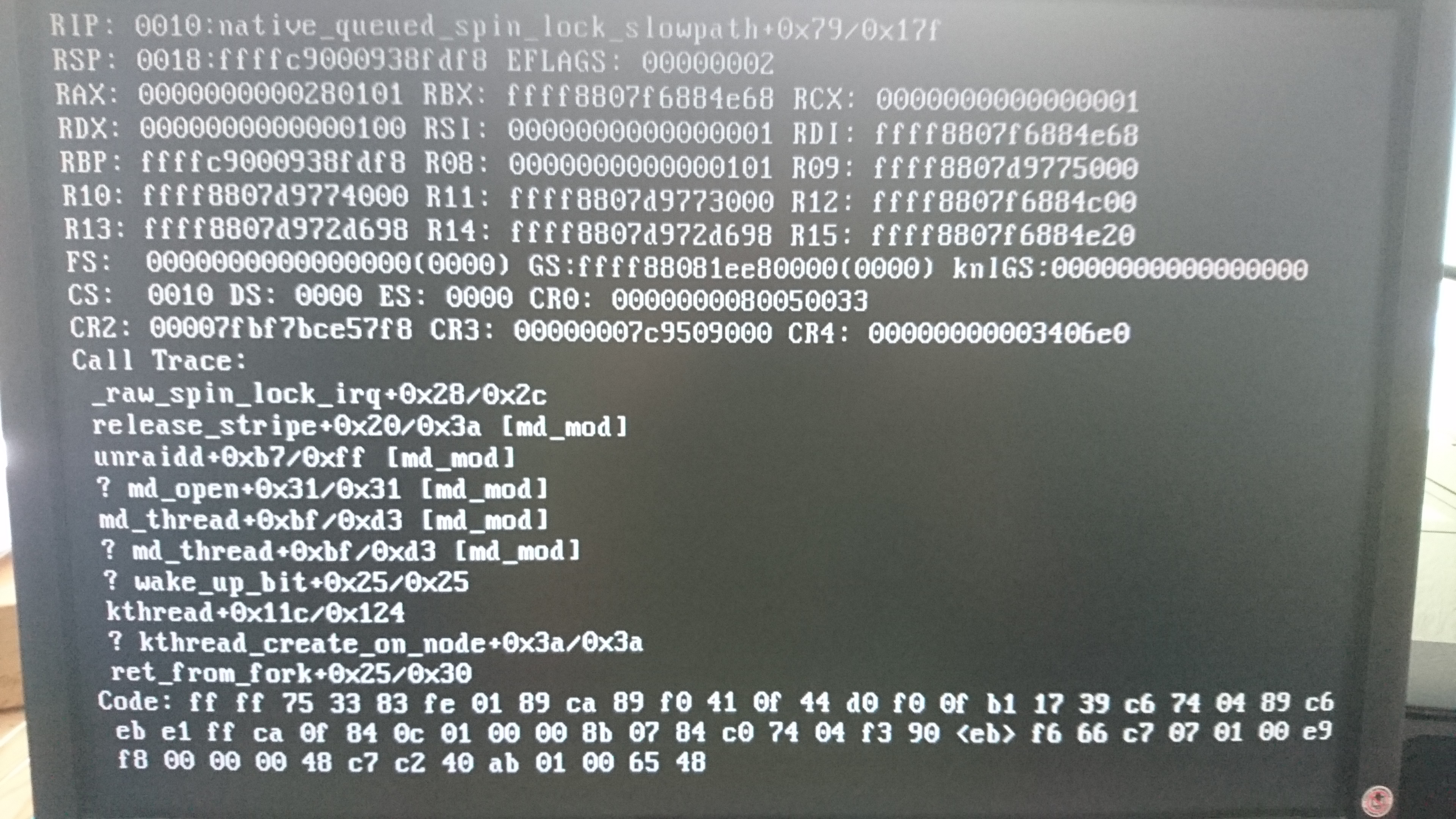

I got home and my server was unreachable again. I had this Problem often. No network Connection and no graphics card installed = no information what happend.
I installed a gtx 560 to see what happend when the server crash. Now i was able to take a picture of the console screen:DSC_0610.thumb.JPG.92dfb1ab1e77a6ee06ddf670bcdcb099.JPG
My Server has a Ryzen 1600 no overclock CPU and 32 GB Ram. The Server only run 3 Linux VMs and a mysql docker.
Unraid Version: 6.4.0-rc9f
Have anyone an idea?

Update: now is it crashed again... i have no idea why
Since no one else has jumped after looking at your picture of the crash, I will propose that you see if you can get a bit more information to the Gurus to work with.
Install the Fix Common Problems plugin and turn on the troubleshooting mode.  That will write periodic log files to the logs folder/directory of your Flash Drive.  After the next crash, up load those files in a new post.
