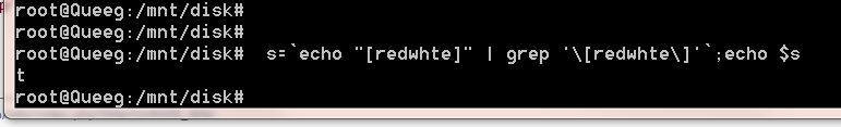

When I run this in a telnet window it returns only the letter "t".  Why?
s=`echo "[redwhte]" | grep '\[redwhte\]'`;echo $s

Weird.  Here is what I get every time.  I distilled the actual code down to just this but it happens every time in a script that runs as root.

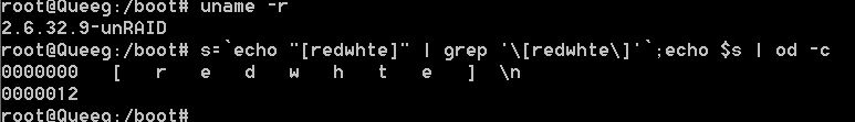

Try
s=`echo "[redwhte]" | grep '\[redwhte\]'`;echo $s | od -c
Let's see what you are actually echoing, not what your shell might be hiding from you.

See attached.
Oh, dang.  Remember back a few days when someone posted this.  I stuck it in my go script and forgot to take it back out.
It just hit me that maybe...and yep, it messed stuff up.  Gads, I'm sorry.  Wow, I just learned my lesson.

I doubt it was that, but yes, something has messed up your shell.

Ok, this is weird.  I took that out of the go script and then tested again and I get back the whole [redwhte]  string.  Yet, they can't be related because I didn't run the go again.  What's happening?  Immediately after running your script piece with the od -c I edited the go script and then started working correctly.
Edit:  I rebooted and it's not happening anymore.  Thanks for helping.
