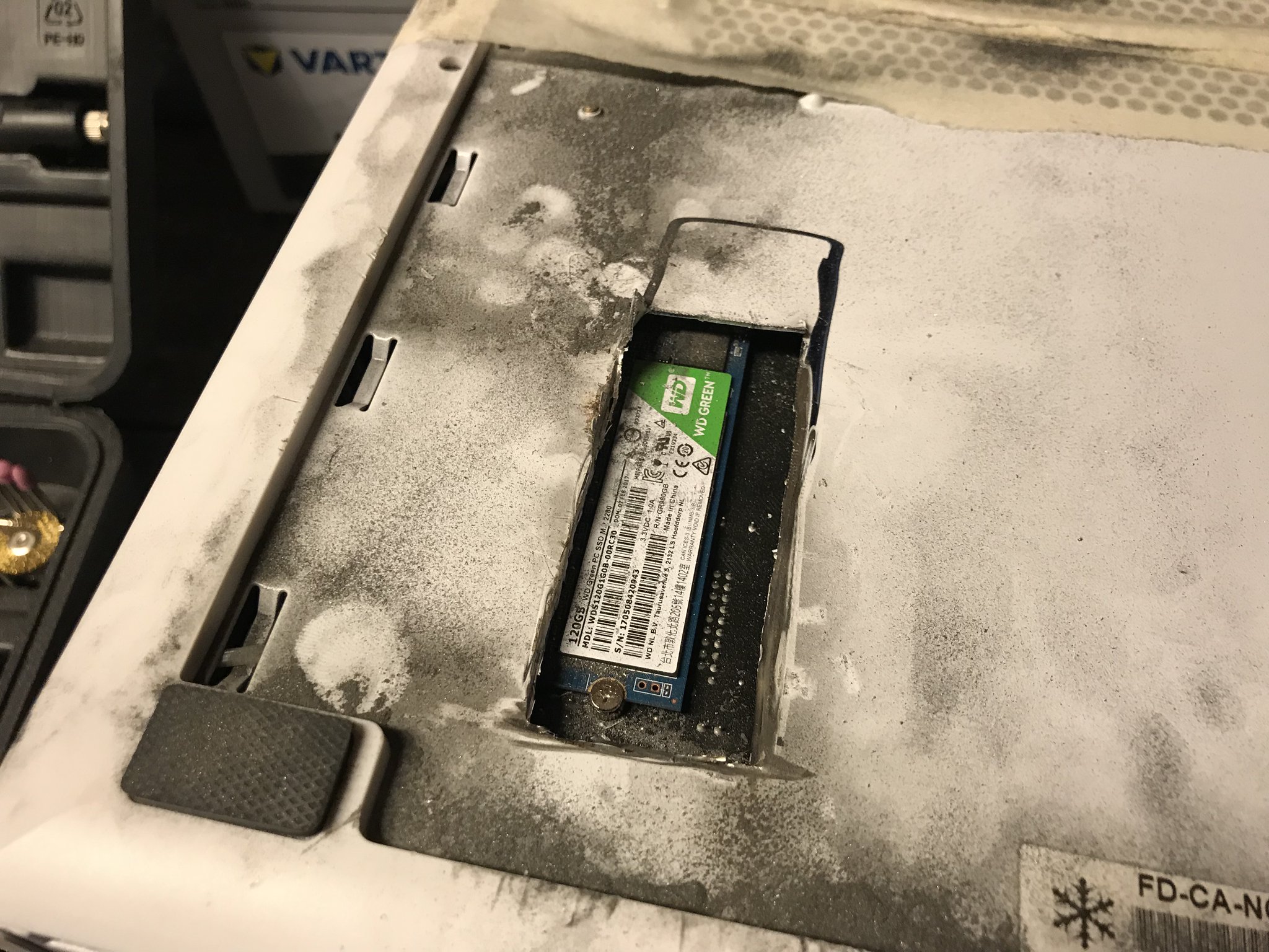

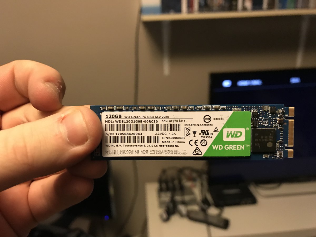

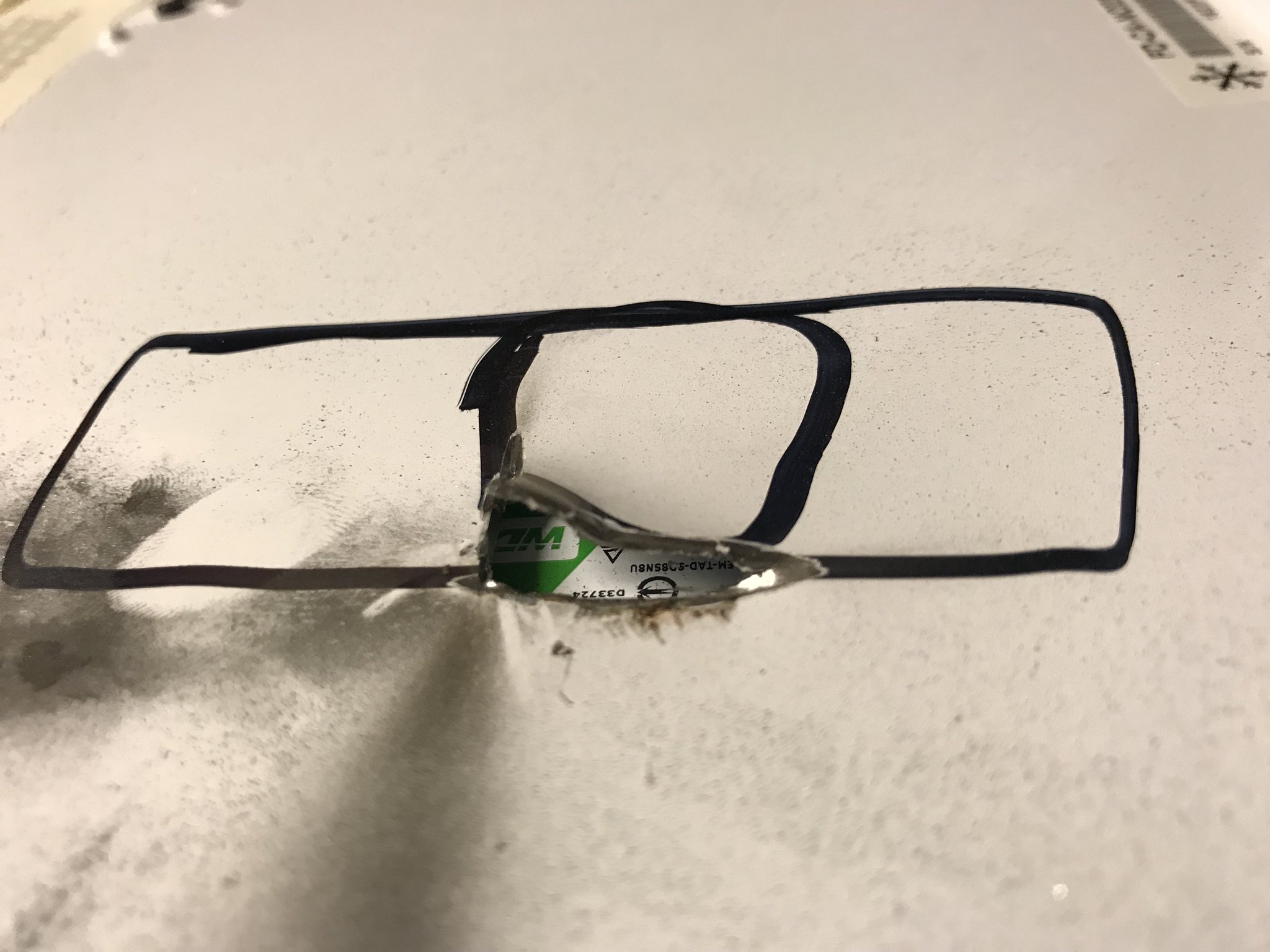

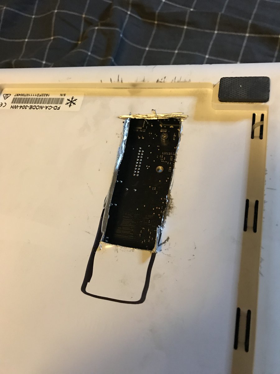

The bad news: I could not use the WD Green M.2 SSD. If I had it plugged in it would disable one of the valuable SATA slots as it is a SATA SSD, not a NVMe SSD (this is the first time I use M.2 so I had no idea about this stuff), so I had to take it out (which in itself was a problem, because the M.2 slot was "under" the motherboard, so to take it out you would have to remove and disconnect everything, because the FD Node 304 case does not have a cutout underneath the motherboard. Because I was very pleased with my cable management, I didn't want to disconnect and re-do everything, so I just used a dremel to cut up a hole and take the M.2 SSD out that way.)
That's normal, WD Blues are also SATA, blacks are NVMe and relatively cheap.
