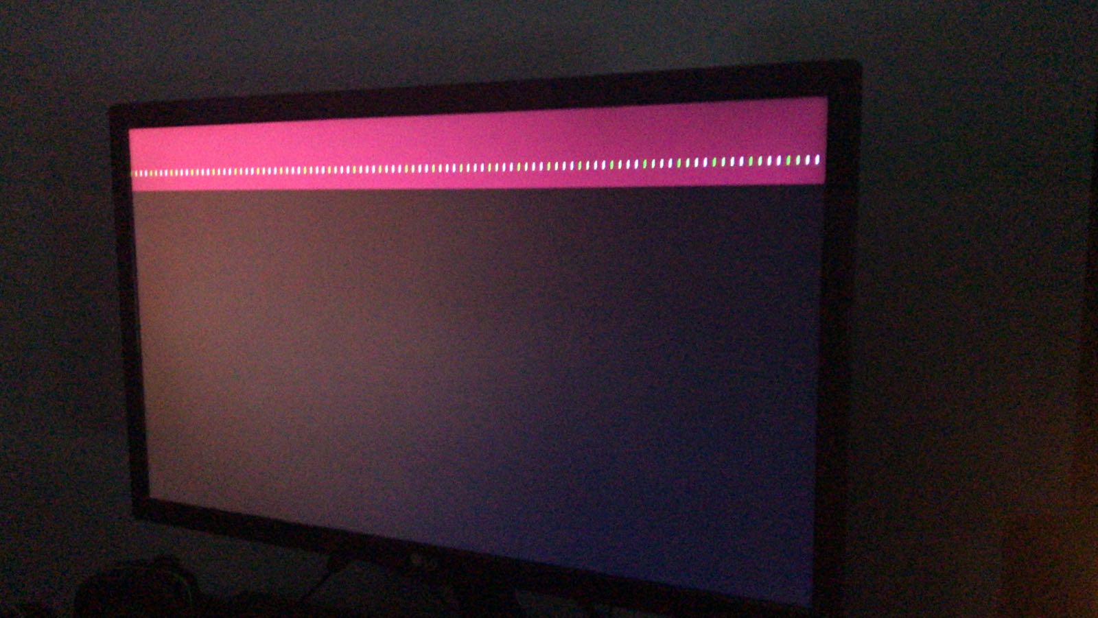

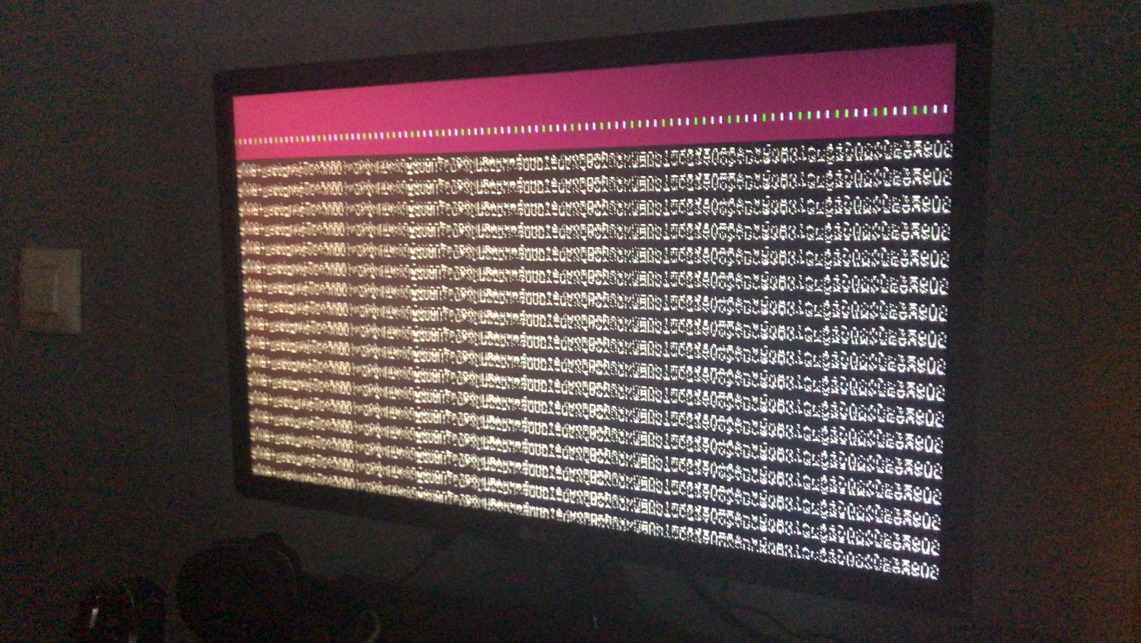

Hello community,
I am newbie with the virtualization in general. I have a home computer and I did 2 computer for gaming with 1 tower. Before unRaid I tried it with KVM but I migrate to unRaid because it is more easy and it saves time to me and effort.
Well, actually I have got two VMs with Windows 10 working successfully. My problem is with a Ubuntu VM. When I try to boot it I get a blocked screen:
ubuntu-gpu-1.thumb.jpeg.c57cfac5cc7a8f5daa0cf40259268815.jpegubuntu-gpu-2.thumb.jpeg.ff7d25e3d53751d4d5ffa90deeb98074.jpeg
I have tried several configurations. The GRUB is showing with the options to try Ubuntu and install it but any option goes frozen screen.
My first step was install Ubuntu but the GPU passthrough was not working so I installed it via VNC because when I tried to install Windows I had got problems with the GPU too similar to this one. My problem with Windows 10 was fixed waiting to the screen. After some minutes the screen was showed and I was be able to install Windows. In the first login I had got the same problem with my two Windows but now both ones are working correctly ever since.
So, this solutions is not worked with Ubuntu. I have installed it via VNC but with the GPU is not working, neither in the install process, neither after to be installed.
I don't know if the problem is with the GPU ROM or something like that (my graphic card have UEFI) but the Windows are working correctly. Or maybe the problem is with drivers and I should install the drivers via VNC...

I have created the Ubuntu with the template. Because it is not working I have tried changing the configuration to I440fx (it was in Q35), using OVMF, etc... I put exactly like my Windows too (same CPUs, same GPU, same machine...) but it is not working neither.
For other hand, I had got my two GPUs together in the same IOMMU GROUP so I had to enable the ACS override to separate them. It is working perfectly with both Windows (each GPU works at the same time in different VM).
Could somebody help me?
Thank you very much!
Kind regards.

I have solved the problem.
The problem is not with the GPU Passthrough. Really is with the default driver of Ubuntu.
To solve the problem I had to install the NVIDIA driver via VNC. So I am going to put step-by-step if it is helpfully:
UPDATED:
Really you just need to install nvidia-384 packet via apt-get. After you can reboot with the GPU attached and now it will be working.
OLD:
1) First create the VM Ubuntu with the VNC as the main graphic device and your GPU as secondary.
2) Install Ubuntu via VNC.
3) Access to Ubuntu and download the NVIDIA drivers.
4) Before Install NVIDIA drivers, you need to disable the NOUVEAU driver which is causing the error.
4.1) For disable, create the file:
sudo nano /etc/modprobe.d/blacklist-nouveau.conf
4.2) Add the lines:
blacklist nouveau
options nouveau modeset=0
4.3) Install dkms and regenerate the kernel initramfs:
sudo update-initramfs -u
4.4) Reboot.
5) Install NVIDIA drivers.
5.1) For install you need to be without X mode so access to another terminal with CTRL+ALT+F1.
5.2) Stop the lightdm service.
5.3) Enter to runlevel 3:
sudo init 3
5.4) Install executing the NVIDIA installer.
5.5) Shutdown the VM.
6) Now you can remove the secondary GPU and put it as the main.
All is working now :). Thanks to anybody.
P.D: If you have demonic audio with NVIDIA AUDIO on Ubuntu enable MSI of intel:
options snd-hda-intel enable_msi=1
Regards,
Pedro.
