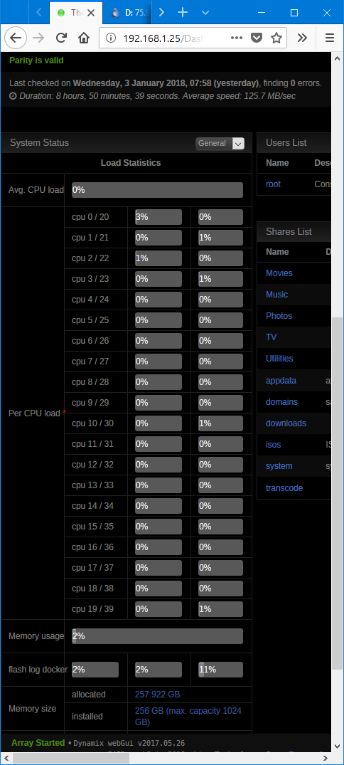

In the meantime, heres a clip of one of my favourite views... ;)
