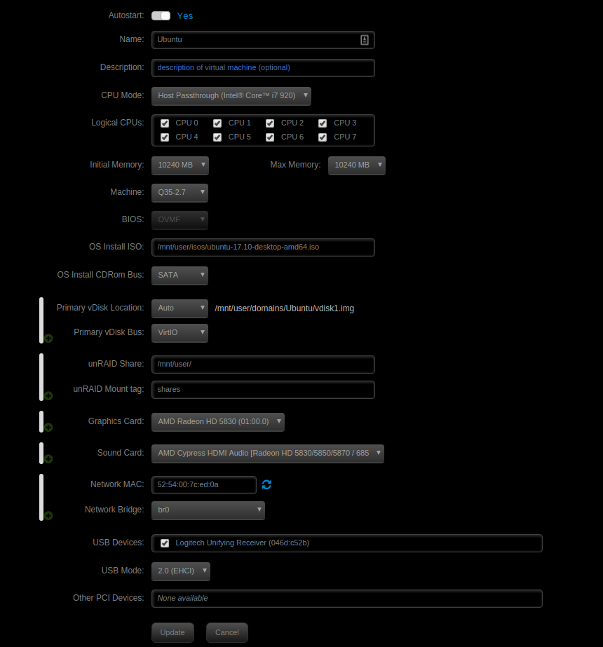

yes, trying to passthrough both. have also tried to choose just the graphics as well, but same problem. this is my setupimage.thumb.png.6849be217059046c161a429b41a378b0.png

I'm not sure this card will work using ovmf. You could try Seabios, but I don't think that is the problem here.

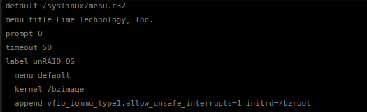

First try to add the below in between append and initrd=/bzroot in your syslinux.cfg.
Go to the Main page of unraid, click Flash and you can add it directly in the syslinux.cfg editor.
vfio_iommu_type1.allow_unsafe_interrupts=1
Edited by saarg
like this?

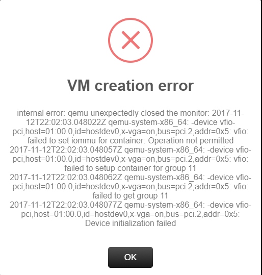

tried with that, and making a new VM with seabios. get the error as shown under.
