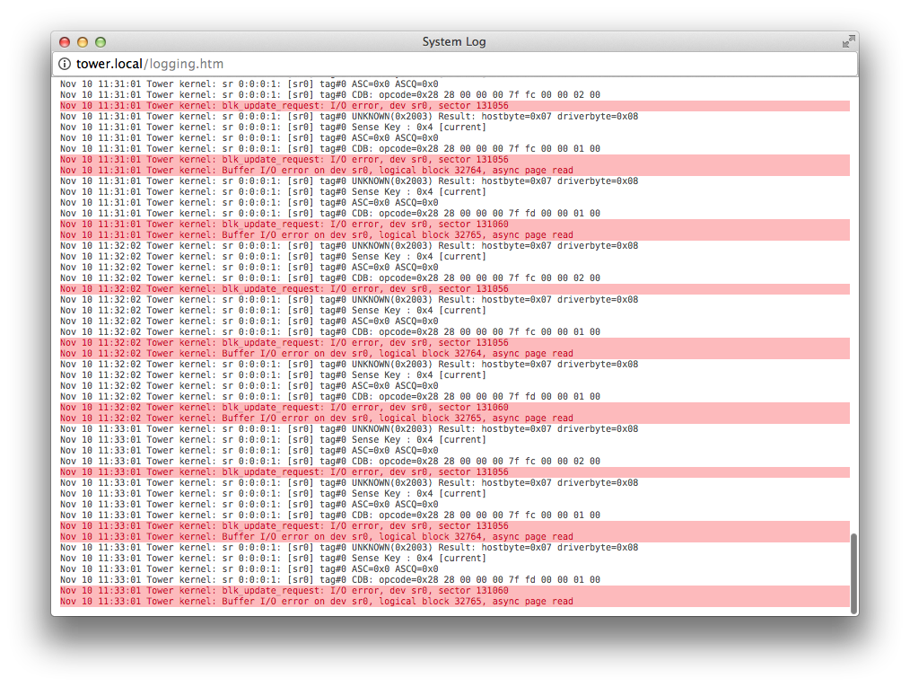

I just installed a new Samsung 850 Pro SSD drive, and I see a lot of error on the system log (please see the attachment). I am running unRAID version 6.3.5

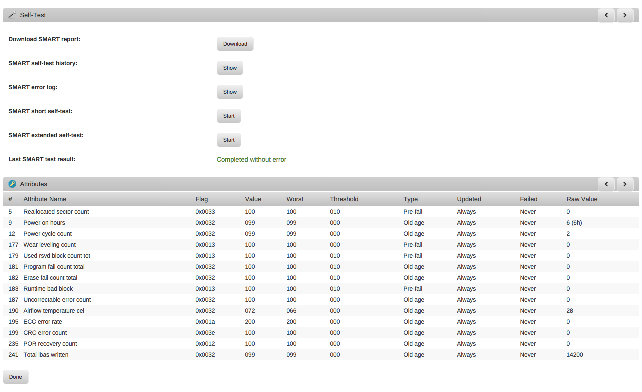

However, the SMART status show green, I am currently running an Extended SMART test on the drive, and will update after it finishes.
My question is: should I return this SSD drive and get a new one?

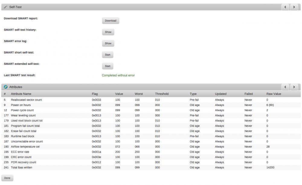

The extended SMART test just ended, and it didn't find any errors on the SSD (please see the attachment).
Next, I'll switch the SATA cable and see if it will fix the errors.

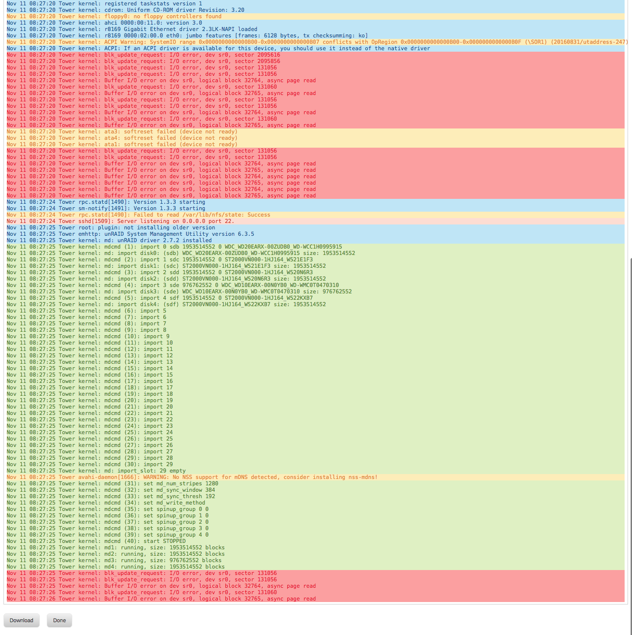

I took off the SSD from my unRAID server, and booted it just to make sure the SSD wasn't causing it.
However, during the booting of the server I still see these errors (please see the attachment). They don't repeat every minute like they did when I had the SSD plugged in, but I still see (almost) the same errors.
The error is complaining about the same sectors: 131056 and 131060, how can this be?

sr0 can't be the SSD, post your diagnostics.
It's your flashdrive, somehow there's a second partiton/function detected as a CD-Rom:
Nov 11 08:27:20 Tower kernel: scsi 0:0:0:0: Direct-Access     SanDisk  U3 Cruzer Micro  8.01 PQ: 0 ANSI: 0 CCS
Nov 11 08:27:20 Tower kernel: sd 0:0:0:0: Attached scsi generic sg0 type 0
Nov 11 08:27:20 Tower kernel: scsi 0:0:0:1: CD-ROM            SanDisk  U3 Cruzer Micro  8.01 PQ: 0 ANSI: 0
Nov 11 08:27:20 Tower kernel: sd 0:0:0:0: [sda] 3907583 512-byte logical blocks: (2.00 GB/1.86 GiB)
Nov 11 08:27:20 Tower kernel: sd 0:0:0:0: [sda] Write Protect is off
Nov 11 08:27:20 Tower kernel: sd 0:0:0:0: [sda] Mode Sense: 45 00 00 08
Nov 11 08:27:20 Tower kernel: sd 0:0:0:0: [sda] No Caching mode page found
Nov 11 08:27:20 Tower kernel: sd 0:0:0:0: [sda] Assuming drive cache: write through
Nov 11 08:27:20 Tower kernel: sr 0:0:0:1: [sr0] scsi3-mmc drive: 48x/48x tray
1 minute ago, johnnie.black said:
It's your flashdrive, somwhow ther'e a second partiton/function detected as a CD-Rom:
Thanks for the prompt feedback! How do I go about fixing this issue? Do I need to get a new flashdrive?
See if that partition/function can be disabled, maybe in Windows, if not ignore the error or get a different flash drive.
Again, thanks for the help. I will probably get a new flash drive, the errors will eventually start bothering me.
