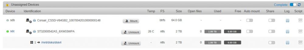

Whilst copying  some files over from a mounted unassigned drive to a share via command line cp command I started to get "unable to write disk"  "disk full" messages. When checking the web interface all the shares i created have disappeared.
Looking at the log it seems i have a hardware issue but cant tell if its a disk or a controller, could i possibly trouble someone with more knowledge than I to take a look at my log file?
I suspect a reboot will bring the shares back but thought i would wait.
Attached log and diagnostics file also a screen shot of the disks.

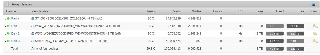

23 minutes ago, brownster said:
The drives aren't full, i think that error was more down to access to the drives
Disk1 was completely full and giving out space errors before the filesystem shutdown.
