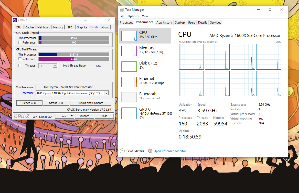

Her is a cpuz screenshot of the bench ran in my VM with 4 core 8 threads. Windows can't really tell the CPU freq that really running of AMD cpus. I had to reference it against the 1800x because the 1600x wasn't in the drop down. Not to bad.
Interesting.  So Windows TM doesn't know better.
Air cooling and 3.925 GHz?  Maybe there is hope for me yet.  I'm running an open air case with air cooling myself.  I'll have to test tonight.  Just curious, how are you getting temps?
Cryorig h40 ultimate is a Water cooler with a little fan on top of the cpu block. Guess for cooling the board and the vrm. Works really well.
