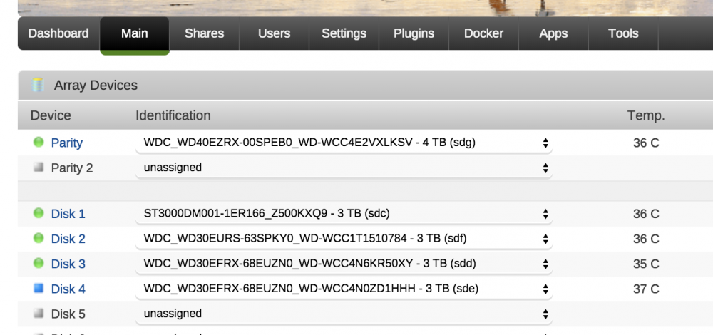

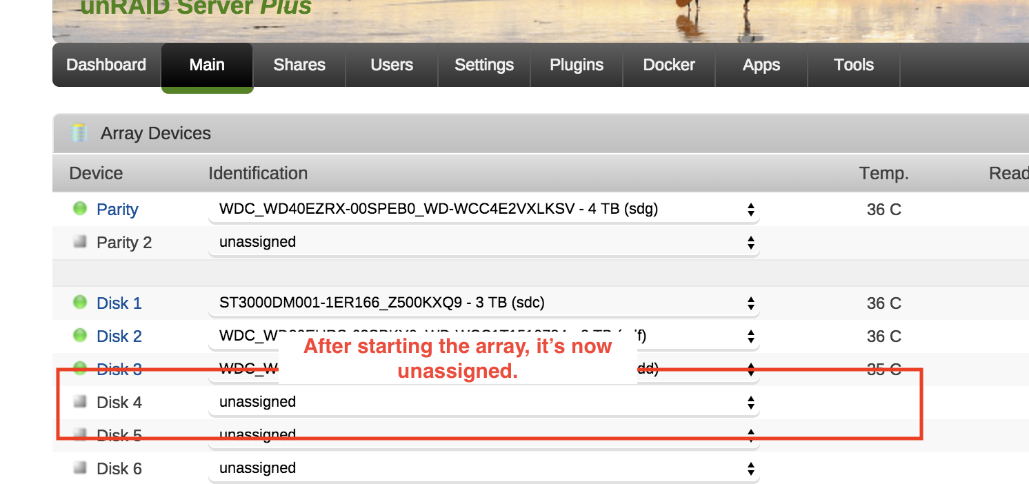

Good morning everyone, I am trying to add a new disk (3tb WD Red) to my array. On bootup the disk is listed under the unassigned drives, I choose a slot for it, hit start on the array and after the page refreshes, the disk is not in the assigned slot, nor in the unassigned disks area. It completely disappears from the system until I power it off and on again. What's going on here?
