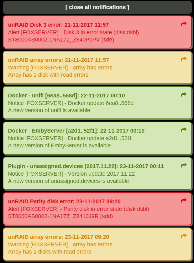

My Unraid system experiences drive failures every few months. (image 1 - Error Messages)
My diagnostics files are attached (both before any reboots whilst the drives are in error and after a cold restart).

SMART status reports indicate no errors, and indeed when I have put the disks back in the array they seem to continue functioning for months at a time before it happens again....
Has anyone experienced something similar? Could it be some issue at the hardware (RAID/SCSI controller level)?

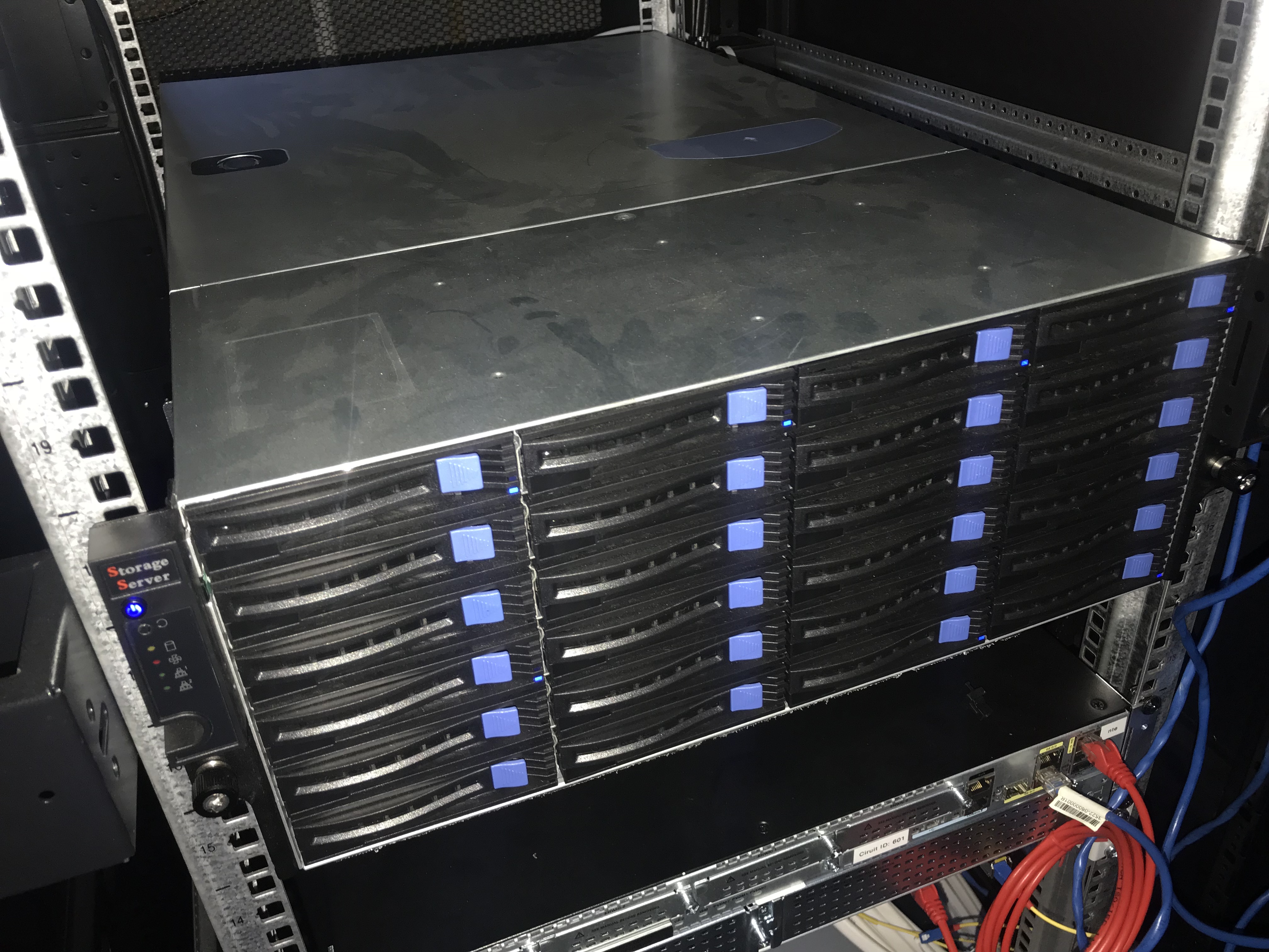

I have a rack mounted server that looks like this... (24 hot swap bay enclosure)
How it works internally I am not sure, but someone else suggested maybe I should invest in a separate hard disk controller?

It may be the controller, the enclosure itself (like the builtin expander), power supply, etc, you'll need to start swapping some parts, if you had a way of connecting 4 disks to the onboard SATA it would be the fastest way to see if the issue is related to the HBA or the enclosure/expander.

This issue does not occur frequently though (i.e. it may not be an issue for several months if not longer)... So connecting to an onboard SATA may not immediately prove or disprove anything. But I hear what you are saying, there is some sort of issue between the motherboard and the hard drives.
