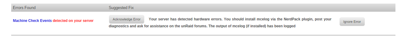

mcelog isn't installed, so no way of telling what happened.  Install mcelog via NerdPack then rerun the tests in FCP and more details should be forthcoming
I did so and saw some memory issues.
Took all the sticks out, blew some clean air in the slots and all is good :)
