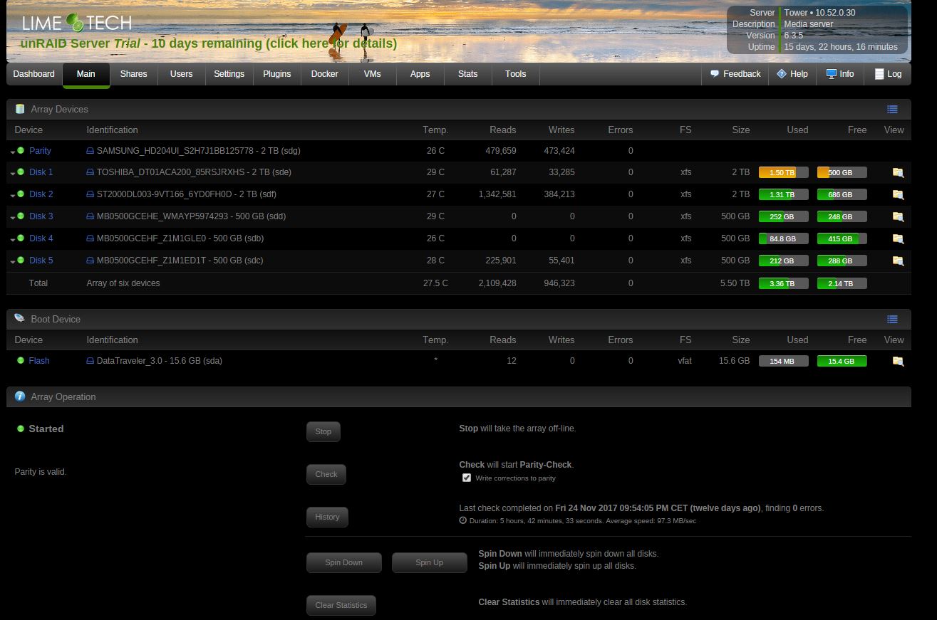

I tested to spin down my unused disks with the green button on [Main] page and then later I started the disk with the same button (now unlit).

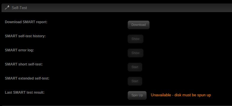

After this was done I cannot run any SMART self-tests and cannot see the test results on the disk. The following is displayed:
[See attached image].. "Unavailable - disk must be spun up" ..
I have tried the [Spin Up] button too but no difference. Still same problem.
I have tried a reboot and also power down of the unRAID server but problem is still there (Unavailable - disk must be spun up).
Is there any way to solve this problem to have the disks available for SMART tests again?

Your Main page doesn't look right at all. It is missing all images. Try to start your system in safe mode and see if this makes a difference. If not, post your diagnostics.
It's a copy/paste of the main page.. hold on, ill make a screenshot and also attach diagnostics.. give me a minute or two ;)
When you press the button "Spin Up" it should make the disk active. Does that happen?
Nope, that does not work. I have both tried the "Spin Up" button and also the grey button on main page.. The button on the main page goes green but i still see the message "Unavailable - disk must be spun up" and the SMART tests are unavailable... :(

Was this ever resolved? I'm seeing the same phenomena, on all my array drives (WD SE 4TBs).
Clicking "spin up" does spin the disk up, it moves to "standby" (a-la hdparm) and green ball, but the SMART buttons are still greyed out and "Unavailable - disk must be spun up". The one button that's functional is the Download button and it works - downloads a perfectly valid SMART report.
Any help would be appreciated.
