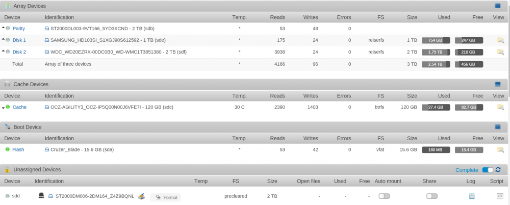

The following is my configuration.

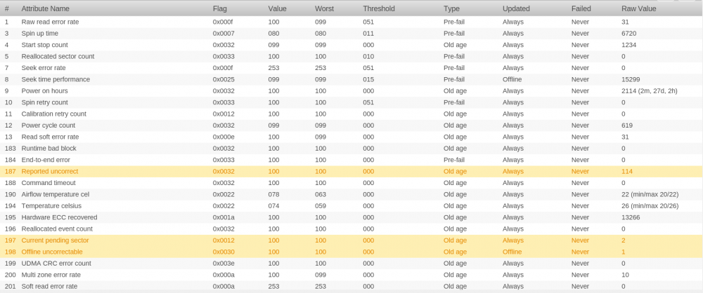

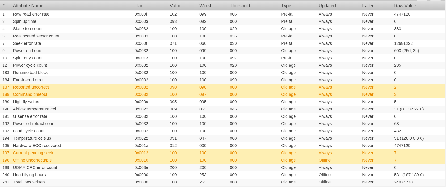

I noticed that my Parity Drive as well as my Disk1 Drive has bad sectors. Please see the smart results for the same.
Parity Disk Smart Results :-
Disk 1 Smart Results :-
I have also attached the diagnostic reports. It has been quite a while since I have done a parity check.
The following is what I would like to accomplish.
1. I want to swap disk1 with a new 2TB disk which I have precleared. Since both the disk1 and parity drives have bad sectors, I am not sure how to proceed on this.
2. I would also like to utilize this opportunity to convert the file system to XFS. I am hesitant to do it because of the bad sector on the parity.
3. I would like some recommendations on the state of both the hard drives for future use. I mean, something like parity disk is ok to use after doing a preclear and rebuild or throw it away and get a new disk for parity etc. Same for the current disk1 too.
On a side note, I have backups for the entire data in Disk1.
Thanks in advance.

If both have pending sectors there's no way to do it without data loss, run an extended SMART test on each before doing anything else.
Thanks. I have initiated it. While the test for Parity drive is in progress, the test for the disk1 drive seems to have failed.
Errors occurred - Check SMART report
I have also attached the smart report. Please let me know if I am doing this correctly.
tower-smart-20171214-0109.zip
If it is of any help, the following is the self test history of the disk failing the test.
Num  Test_Description    Status                  Remaining  LifeTime(hours)  LBA_of_first_error
# 1  Extended offline    Completed: read failure       90%      2114         1536289559
# 2  Extended offline    Completed: read failure       90%      2114         1536289559
# 3  Extended offline    Completed: read failure       90%      2114         1536289559
# 4  Short offline       Completed: read failure       20%      2011         1536289559
# 5  Short offline       Completed: read failure       20%      1816         1536289559

Parity disk passed the extended SMART test, do it's good at least for now, if you have a spare you should be able to successfully replace disk1, if your spare is larger than parity you can use the parity swap procedure.
  • sreeju changed the title to (solved) Need guidance to Swap data disk and parity disk with bad sectors - Unraid 6.3.5
Thanks @johnnie.blackand @pwm for your help. Since I had backups, I didn't rebuild the disks. I used the spare to convert the other disks to XFS and then copied the files affected by the bad disk to the spare. I then rebuilt the parity to a new disk.
