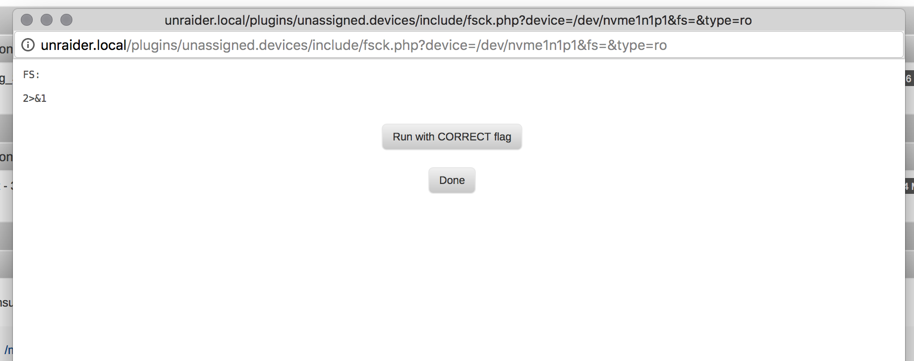

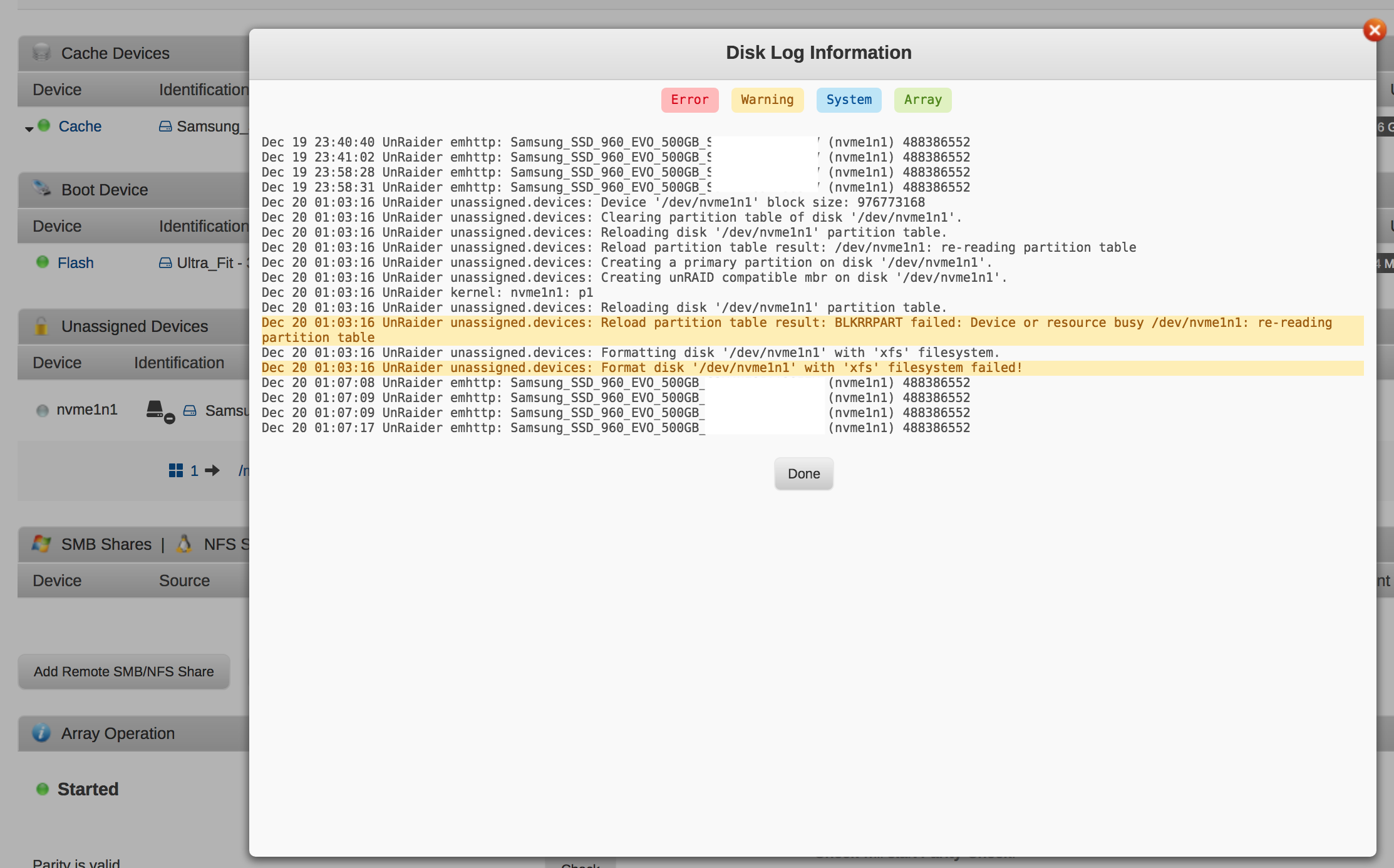

  4. Tried to Format drive in xfs however it seems there was a warning

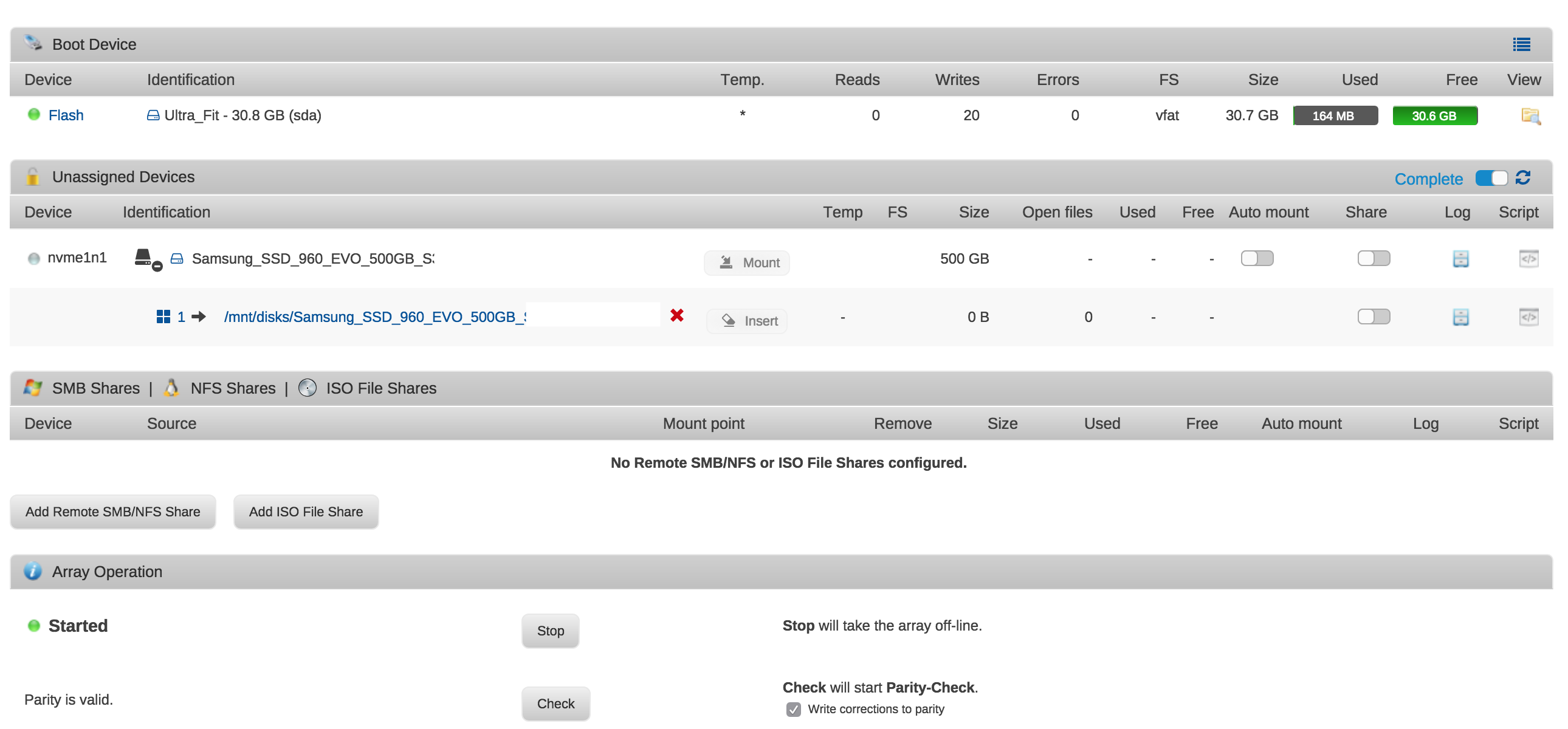

  5. Now i can't seem to mount/insert the drive or do anything else with it
Not sure what the next step is here? Any ideas?

I believe there was an issue with the UD plugin formatting NVMe devices, you can temporarily assigned it as the cache device, format, and then unassign it and mount with UD.
