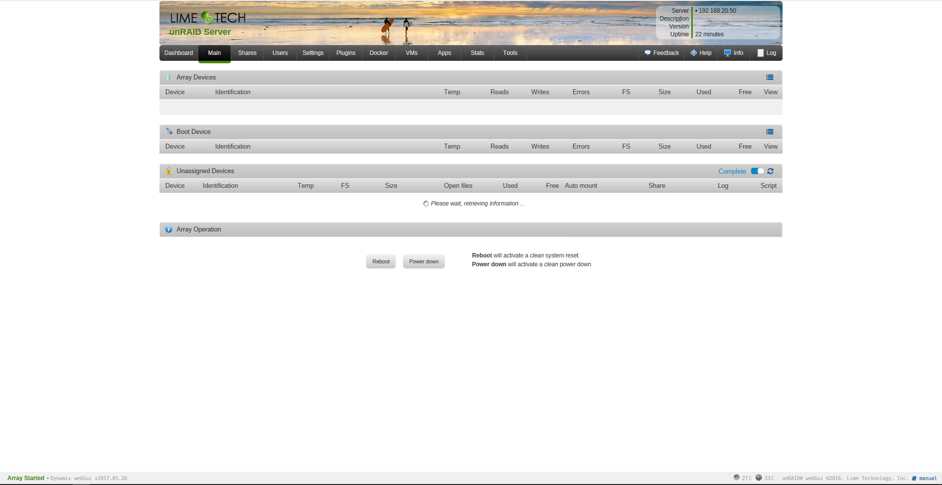

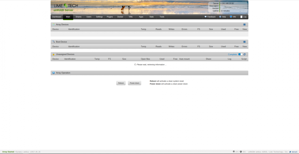

So it looks like while attempting to install a version of the koken docker (photography file management system, php with database) I have inadvertently modified/destroyed/created files which are currently conflicting with unRaid webui. I can not start both radarr and sonarr for some reason (missing from docker ps, along with other dockers. Images still found) and performing tasks in the webui is not possible including obtaining logs. I have also noticed that this isn't an issue while the array is offline, so some offending file/s are located within the array somewhere and not on the boot usb.
The best I could do in terms of logs is attached as UnRaid_Log.txt and there's also an image of what the main page in unRaid looks like. Along with the page looking like that the page title is now referred to as /Main.
How would I fix this uninitialized csrf_token issue? If it means a new copy of unRaid on usb then will I lose my dockers/files etc?
