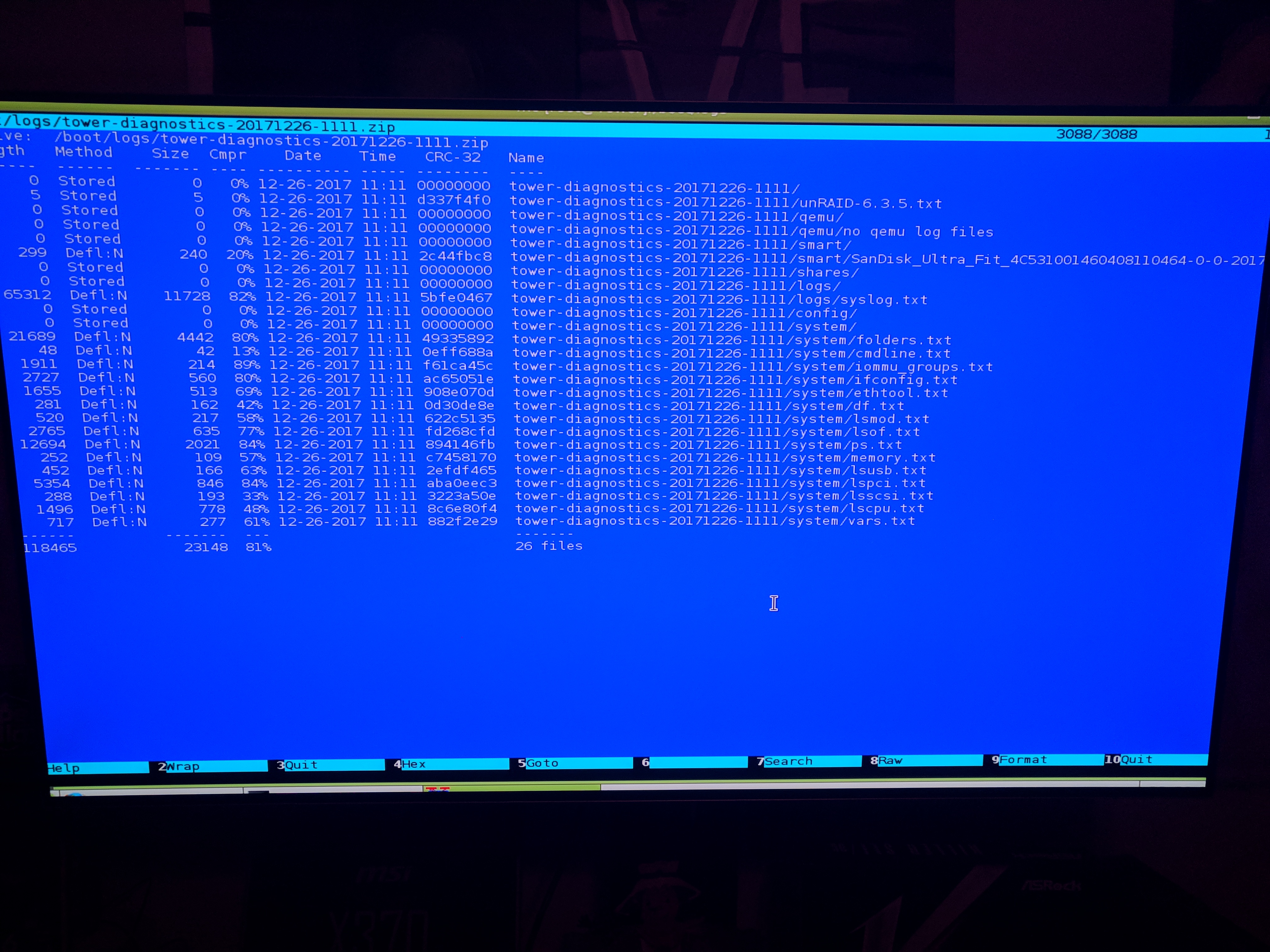

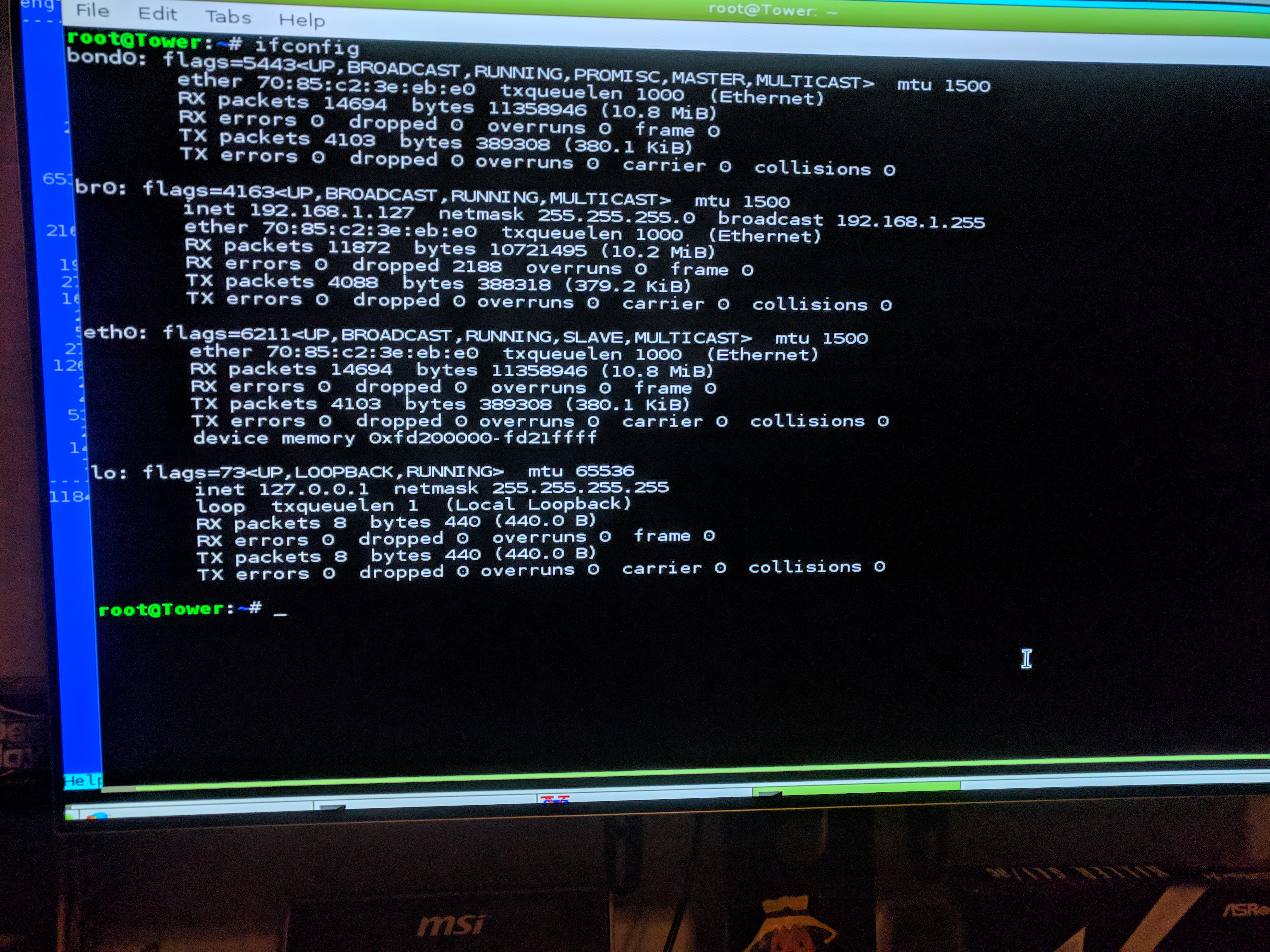

Second set of info: network

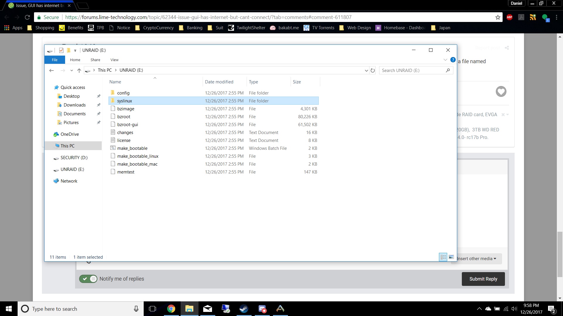

Shutdown the server.  Pull the flash drive out.  Plug it into another computer.  Open up the    logs     folder/directory in the root of that dive.  You will find a file named       tower-diagnostics-20171226-1111.zip       and that is the file to upload.
Ive tried multiple times, neither time did the file or usb drive change. even after it "saved" here is a clip of the usb drive after removing it and putting it on my PC

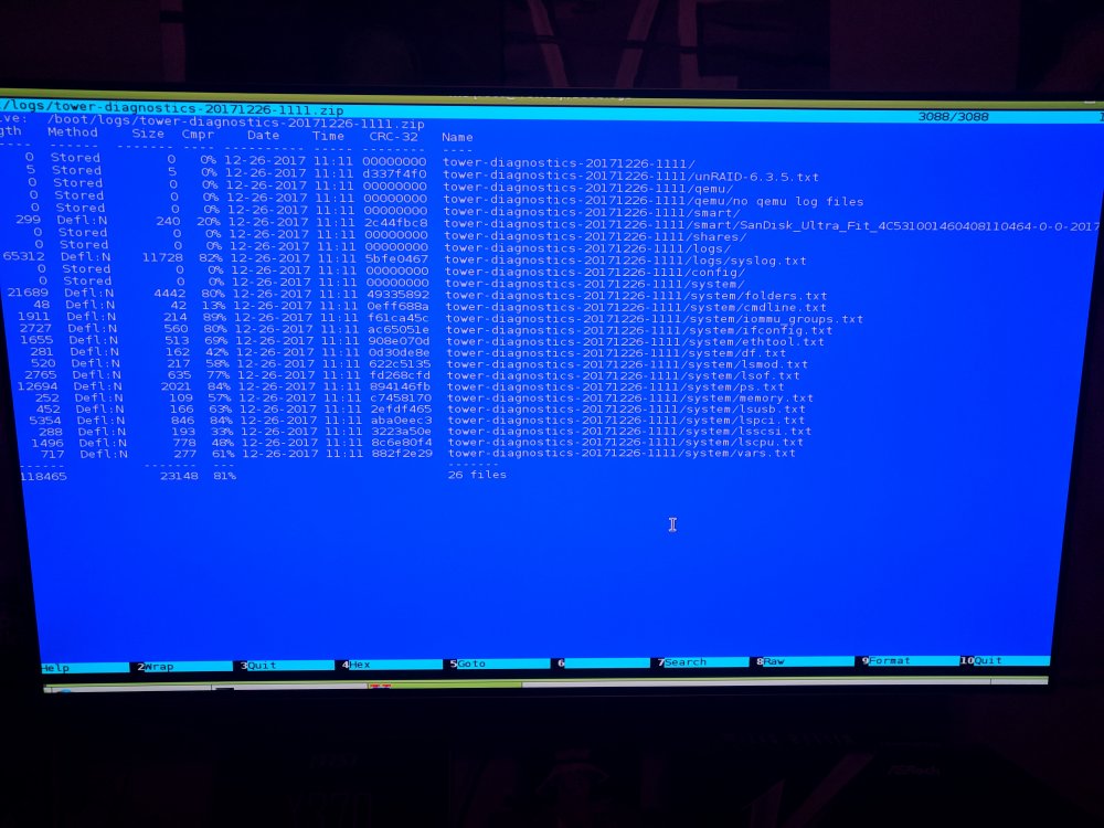

Then what is this in the photo in your second post?
(   /boot   is where the flash drive in mounted in the Linux file system.)

Based on what you ask, it seems like there should be more on the usb after booting the system up then shutting it down, but its the same files/folders as it were when i made it

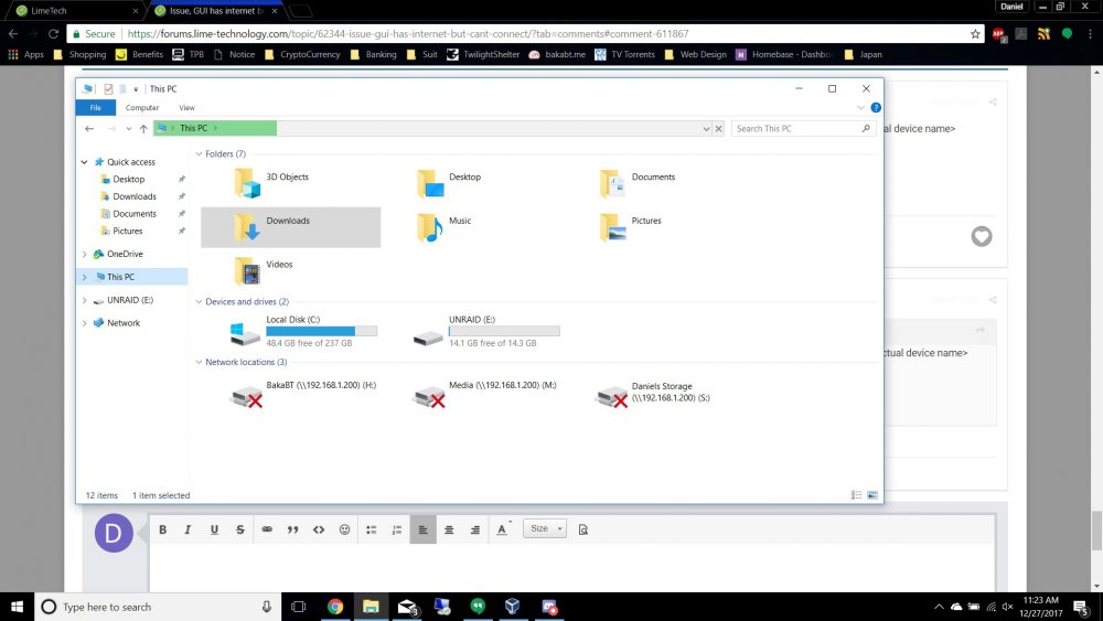

If you insert the USB stick in another computer - does the stick show the volume label 'UNRAID'?

yes, it shows unraid and even used the unraid software to make the stick
