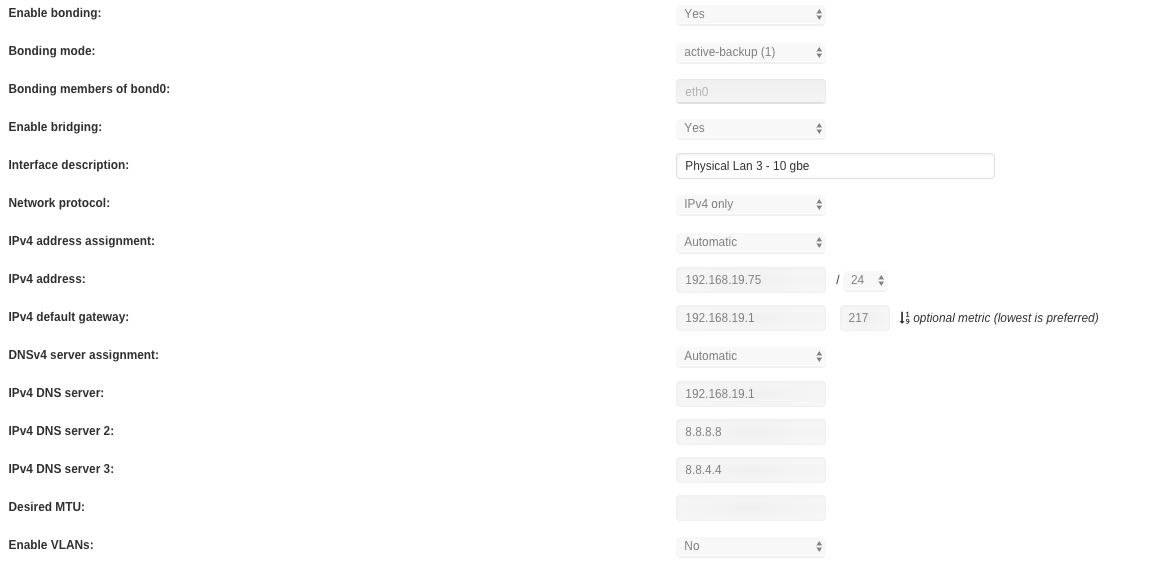

Network setting GUI settings:
.5a4686b9775c7_ScreenShot2017-12-29at11_16_09AM.thumb.png.3e9716ce532f373f6deb6600e18a6412.png
