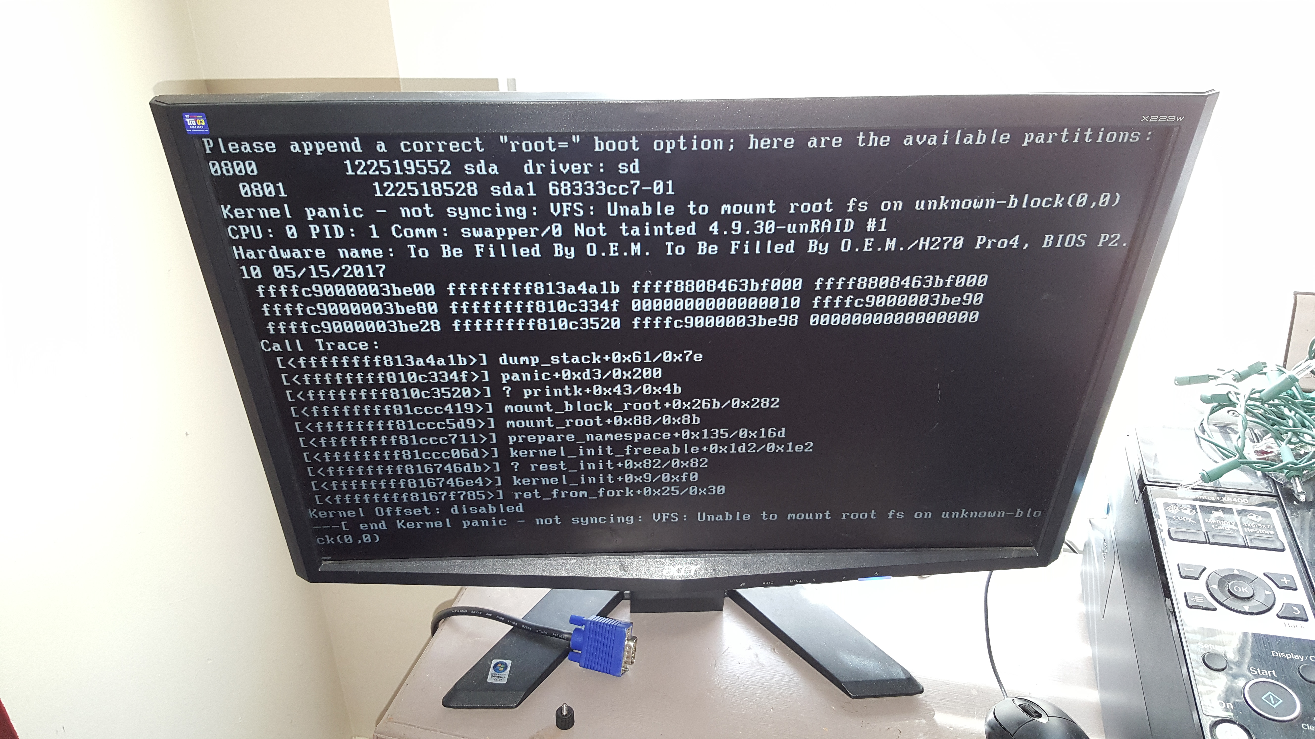

My second problem has been this kernel panic. I have been able to isolate this error to be the only one I see on boot and could use your guidance to help me further troubleshoot (and frankly, understand) what is going on. Sometimes when I boot after memtest, everything works fine; at other random times, I get the panic. This kernel panic happens under all the same tests I already outlined. Can someone explain what this kernel error is telling me?  “kernel panic-not syncing: VFS: unable to mount root fs on unknown block(0,0)” I suspect a clue may be found from my attached screenshot [kernalpanic.jpg]. How do I appended sda or sda1 with 'root' for the system to load?

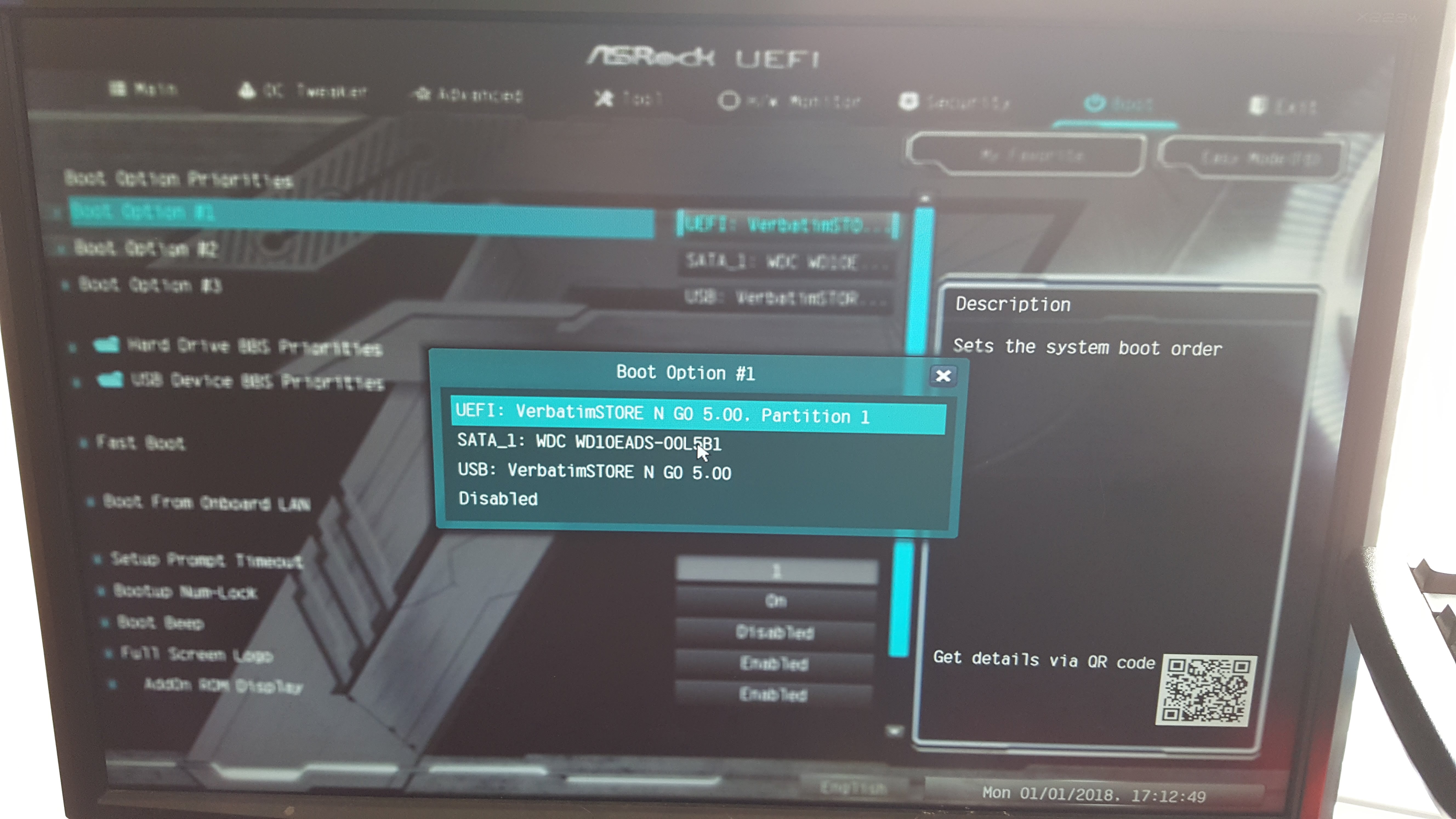

In my bios, it is worth noting that I see a USB and UEFI USB option that can be selected [bootoptions.jpg]. When I pick the UEFI option, it never loads (just puts me back into my bios settings menu). The only way I can load UNRAID, is when the non UEFI USB is selected. This happens regardless of: 1) USB disk (all diff models tried have been 2.0, including brand new fresh install and tests with copies including my config); 2) different placement of the USB on MB with different connecting cables (e.g. tried multiple USB 2 header AND 2.0 case ports, as well as USB3 ports- which caused other errors, so I now avoid); and 3) if I have both USB options loaded as boot priority #1 and #2 in any order.

Lots of lessons learned on this one. The solution: one bad stick of RAM was causing all of this mess. I found this not by running long memtests (in fact they often reported no errors!), but by trying each stick in the first slot one at a time until the kernel fault occurred. After reviewing a lot of related posts, and even my own logs, my issue was not the USB stick, as reported frequently for others. Am really happy my RAM is from G.Skill, as they guarantee their RAM products and am in the process of returning it for a replacement. :) My hope is that this post might help someone else.
One more post to confirm that my replacement stick of RAM from G.Skill resolved this issue. Also worth noting that they kept good to their brand promise and provided me with a replacement without hassle.
