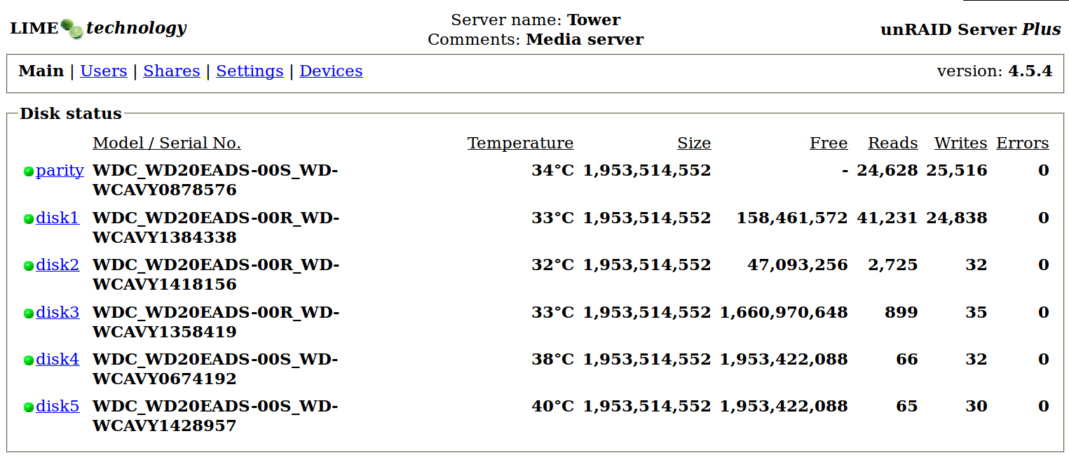

I now have a six disk unRAID 4.5.4 PRO array consisting of six 2TB WD EADS drives. See attached "screenshot.png". I don't use unRAID server "shares" to move data files from my workstation to unRAID server; instead, I copy data from my Ubuntu 10.04 workstation directly to the unRAID disk I want the data saved to with path command: smb://192.168.0.10/disk1/........ using Nautilus.
I understand that Reiser FS is supposed to be more efficient than ext3/4, however, I am confused about a situation I just noticed concerning the number of files and remaining free space on "disk 1" of unRAID server vs. the same exact files (in number and size) on my Ubuntu workstation, using the same make and model WD 2TB hard disk formatted to the ext4 fs. To be clear, my Ubuntu 2TB drive (ext4 fs) is an exact mirror of what is contained on unRAID "disk1" (Reiser fs), the only difference is the filesystem.
My unRAID WD 2TB disk1 shows over 158GB free space! However, my Ubuntu workstation's WD 2TB drive (with the identical files shows only 45.5GB free space.  Why the vast discrepancy in free space between Reiser and ext4? Reiser can't be that efficient. What am I missing?

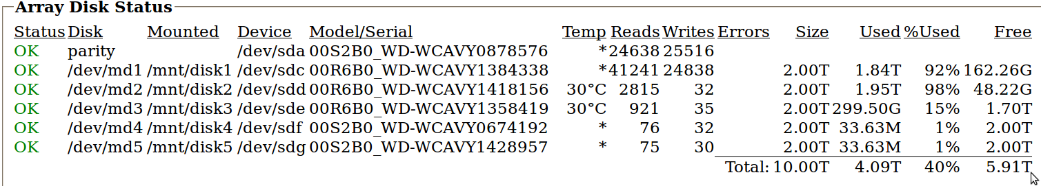

I just ran "Unmenu" and performed a "disk usage check" and it says that unRAID server's "disk1" has 1.9T used which would make more sense. However, when I look at "Unmenu's" array status screen, it's not all that different from the default Limetech GUI. See screenshot2.png.
