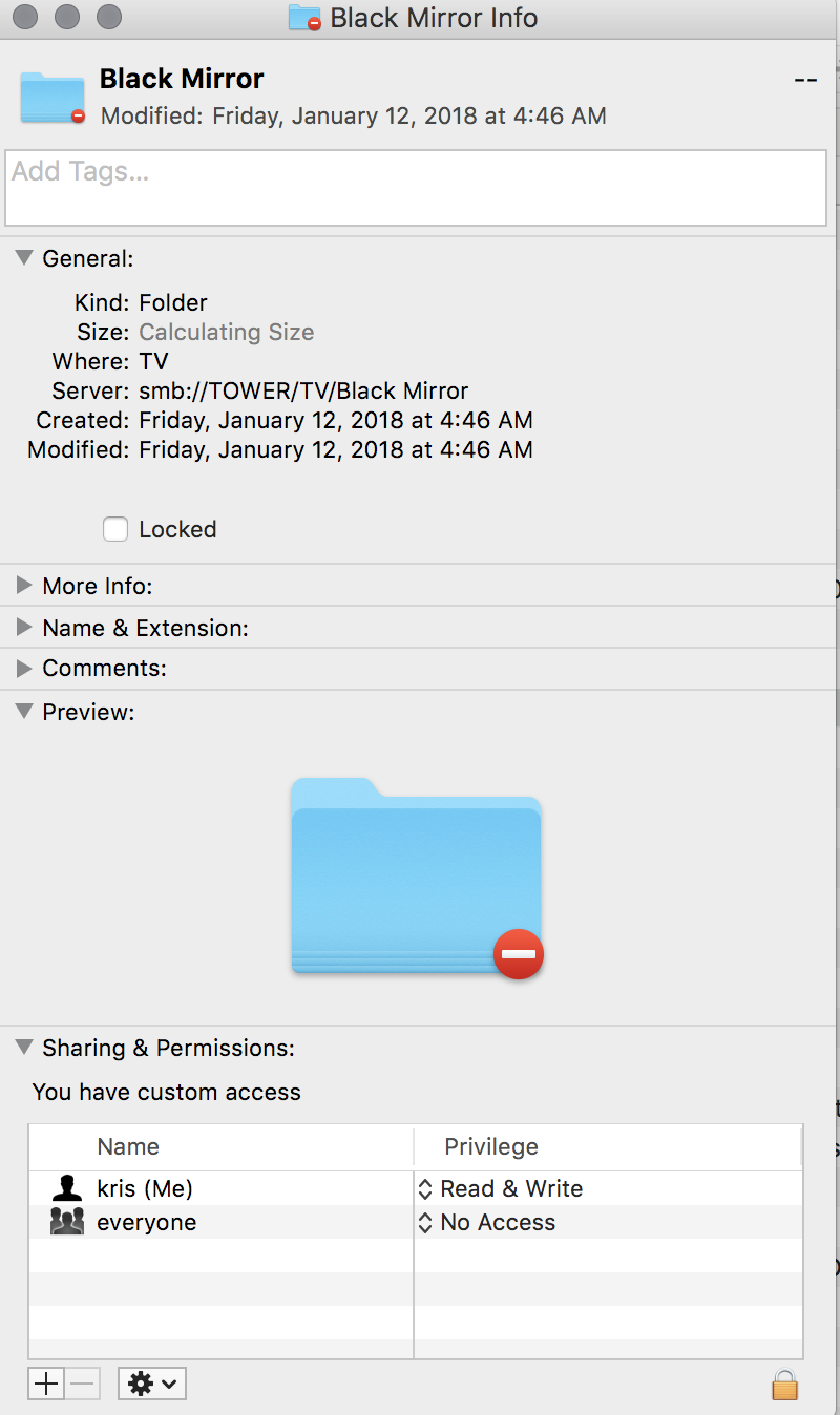

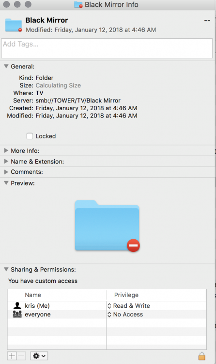

Here's an example of what I see on my Mac for a share that does not have the Enhanced OS X Interoperability feature enabled:

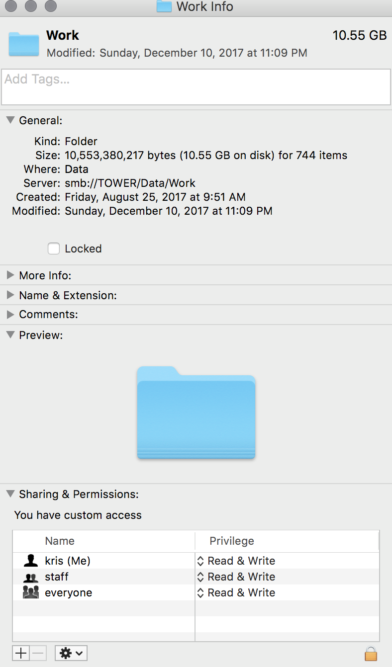

And here's an example of what I see when I do have that feature enabled:
5a5d1de7afa74_ScreenShot2018-01-15at1_31_11PM.thumb.png.f52296c691fbf045fe9d140c679d1730.png
