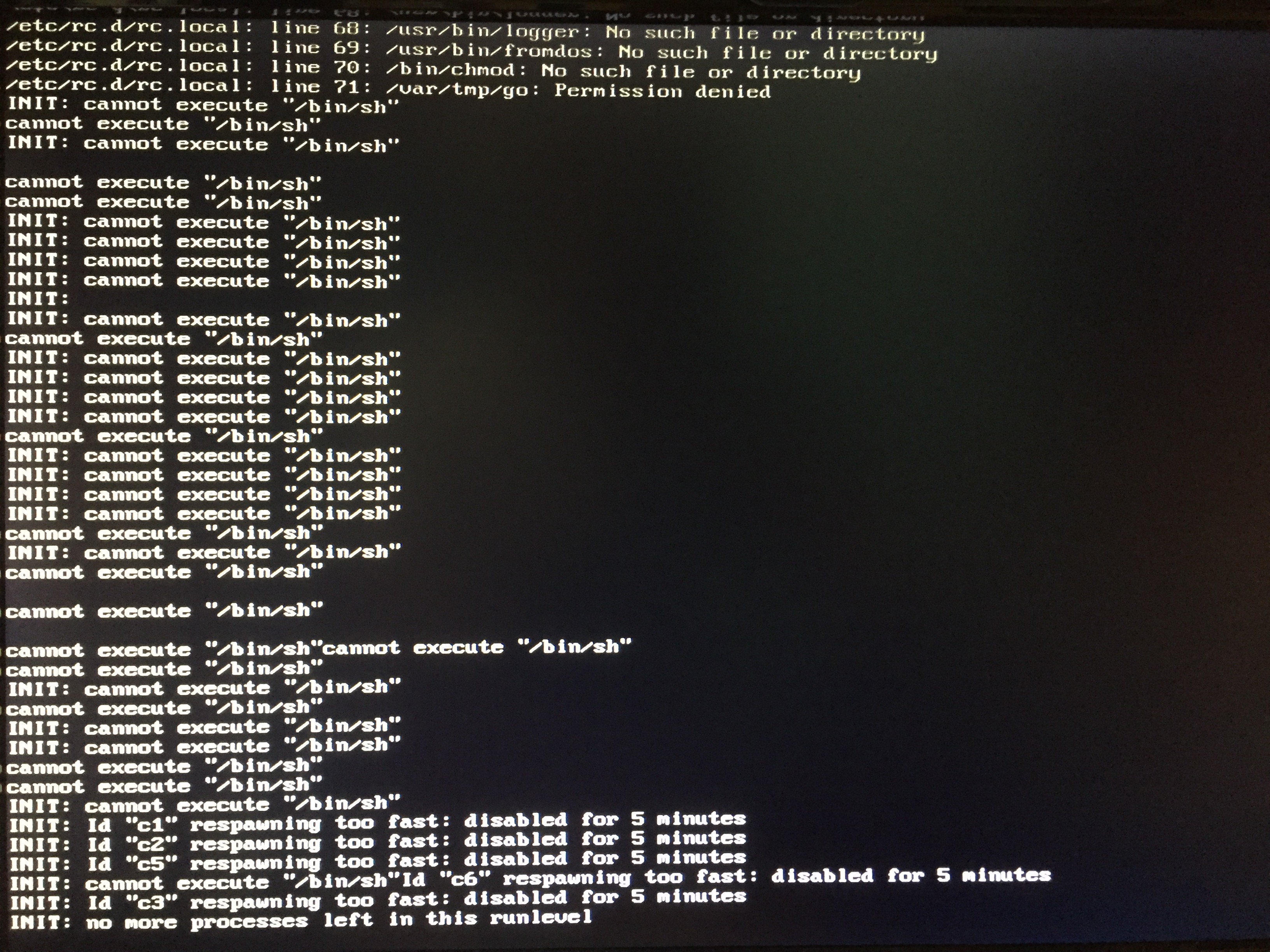

I updated to 6.4.0 through the webGUI from the link "Download Now" on the bottom of the page.
After that, I rebooted the system from the webGUI as suggested, and then the system won't boot properly anymore.
(Attached the screenshot of the system)
I have tried booting in Legacy and UEFI modes, and re-run the script "make_bootable", but no luck.
For this moment, I re-installed 6.3.5 and recovered the "config" folder from backup, everything works fine again in 6.3.5.
Did anyone have the same experience and solve the issue?
You should try booting using a different flash drive with a clean v6.4 install, just to confirm if the issue is related to v6.4 or some config or customization you're using.
