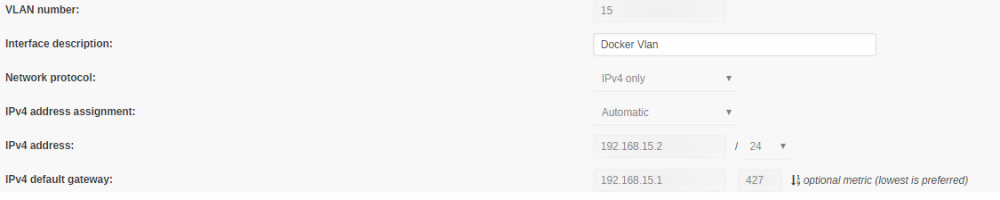

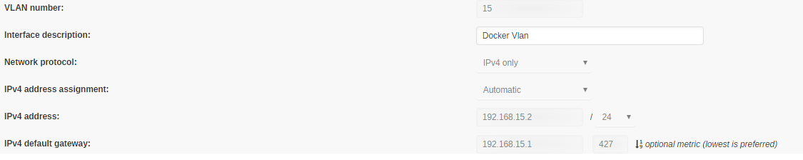

What I am looking for is dockers on my VLAN15 be able to communicate with my unRaid host. My understanding is that macvlan should allow this, because it is going from br0 <--> br1
  • unRaid 6.4
    • Eth0: 192.168.7.251
    • Eth1: <No Assgined IP> (screenshot below)
      • VLAN Number: 15
      • Network Protocol: IPv4 Only
      • IPv4 address assignment: Automatic
      • IPv4 address: 192.168.15.2/24
      • IPv4 default gateway: 192.168.15.1
  • pfSense router (192.168.7.1)
  • Main network: 192.168.7.0/24
  • VLAN15: 192.168.15.0/24
Interface eth1

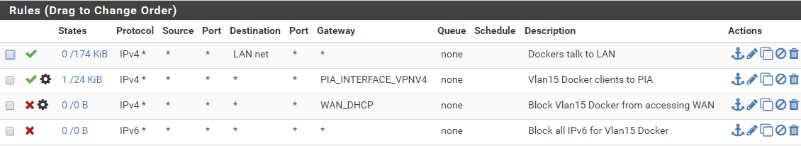

If i setup a docker on the VLAN15 network (i.e. 192.168.15.11) it cannot communicate with other dockers on unRaid as host (192.168.7.251). I have the it enabled in pfSense (I want it so anything in VLAN15 goes out through my PIA VPN):
VLAN15_DOCKERS
LAN NET
For example, if I assign hydra2 to br1.15 with an IP address of 192.168.15.11, it can access the internet through PIA, see my network EXCEPT my unRaid host (192.168.7.251). It also cannot see unRaid on my VLAN network (192.168.15.2)

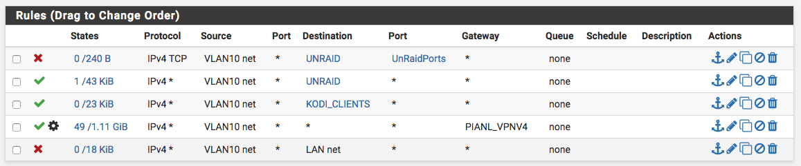

I'm also using pfSense and I've attached my rules for VLAN10:
