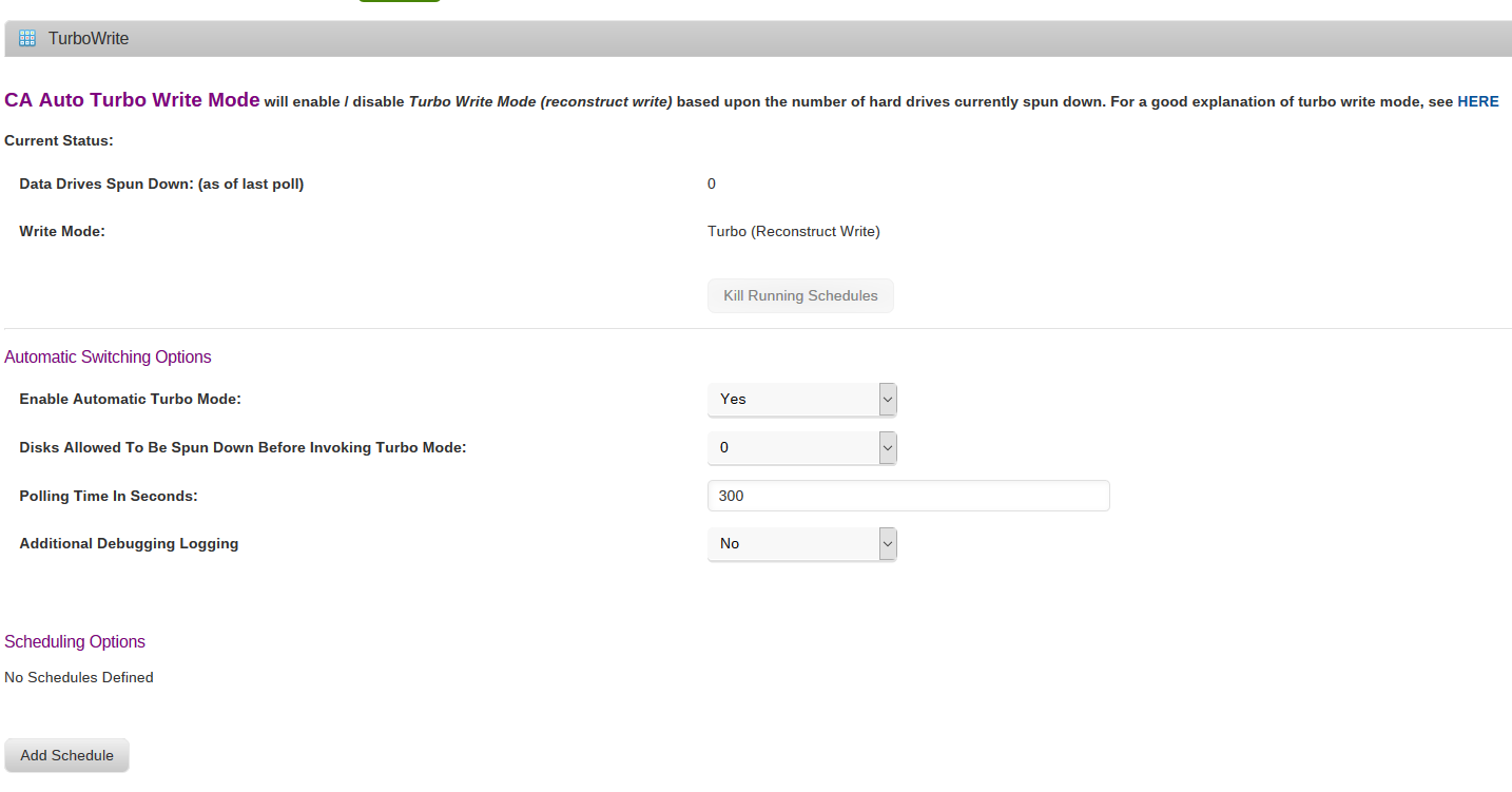

now i have tried Turbo Write. it did not help. i still get 60 MB/s
Edited by DigitalLF
still nothing.

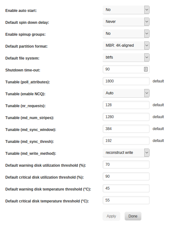

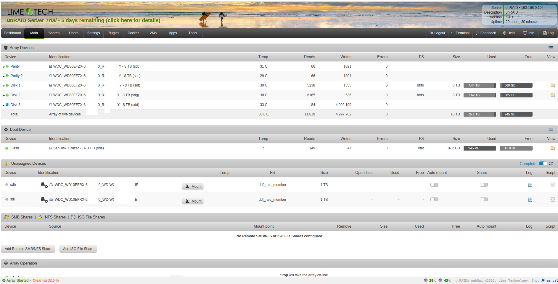

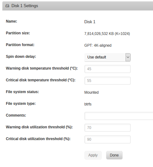

Here are a few screenshots that might help! reminder!! this is running in a VM in ESXi from a usb drive with PLOP but it has worked.
As you can see in the first picture right now I'm adding one disk so and NOT transferring anything. Avg. CPU usage is 4% and mem usage is 49%

I never virtualized unRAID, maybe there's a performance hit.
Also, test again after the disk finishes clearing, though not part of the array yet unRAID doesn't really perform well when doing simultaneous I/O.
i did try it before i added the last drive. it was the same.
