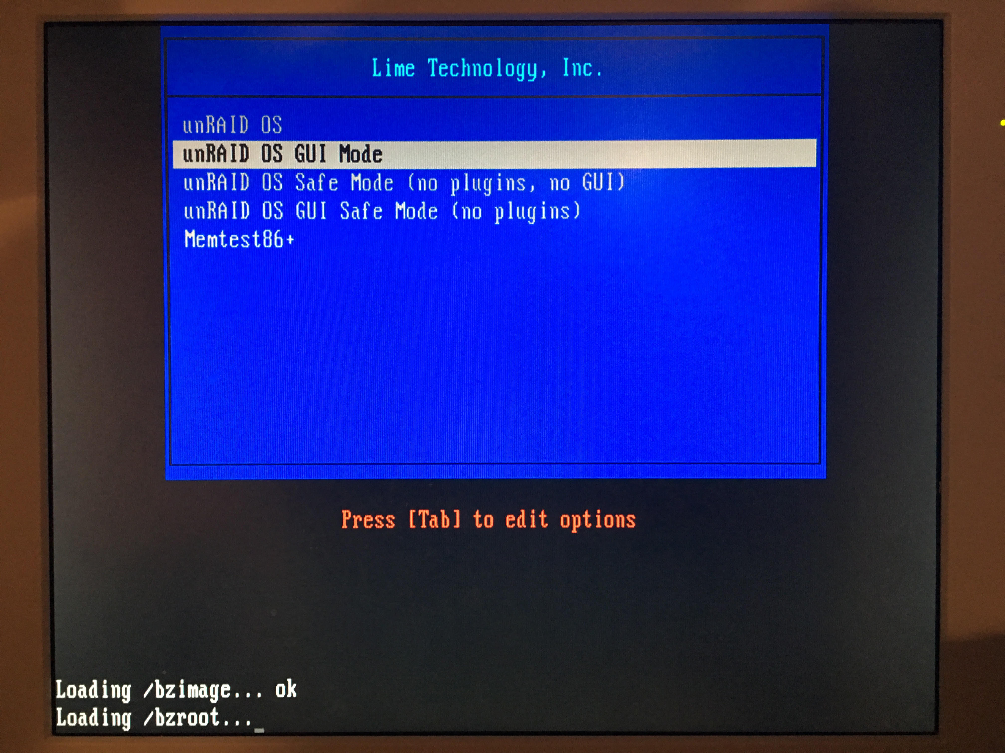

Any help would be great.  Running Unraid successfully for a couple years.  Tried upgrading this morning to 6.4.1 and the box wouldn't come back online.  I plugged in a computer monitor the box and see the windows stuck at the screen in the attached image.  Basically seems stuck at bzroot.
Thanks in advance - Mike5a846c4be0137_uraidbootupissue.thumb.jpg.8ddb9ca0a732bde34c16ba39c29d7be7.jpg

Thanks,  I went ahead and did that.  I backed up the flash drive files first.  Copied in the download  bz* files and replaced the current files and the os load stopped at the same spot as the screenshot.

At this point the box gets to "OK" on the bzroot and then just reboots the computer over and over.  Any suggestions would be greatly appreciate.  I would even be happy to just get 6.3.5 loaded again if I can backwards on this flash drive.  Again I can zip and upload any files that are needed for review.
