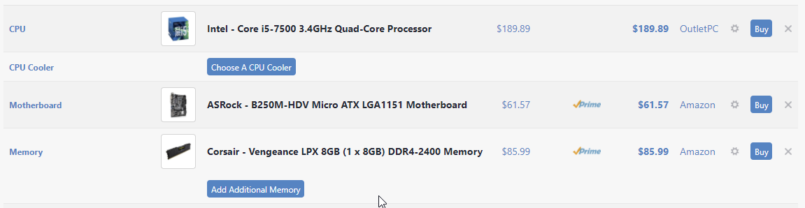

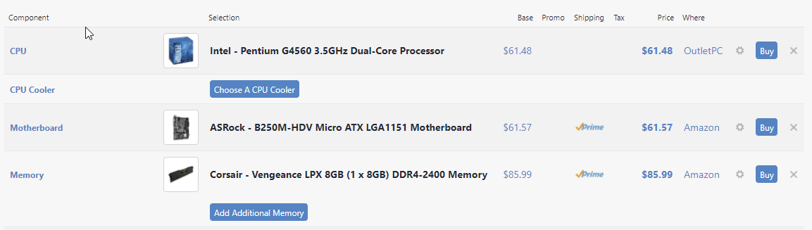

Some possibilities?  Not knowing what I want to do processor / VM / Docker / etc wise, hard to tell which would be logical.  Price jump is pretty huge.  Also 1x8g, can add another 1x8g later if I determine it's needed.  Board is smaller and will fit well, has m.2, 6 ports for initial support, relatively lower power usage, etc.
Use current SATA card, use different?  Compatible?

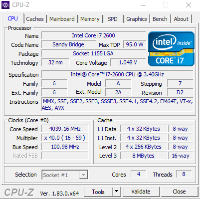

Another alternative... I'm probably going to replace my gaming rig, which while older, is quite a bit of beast and actually has more umph than the i5-7500 I posted (and that's without the healthy stable 4.4 GHz overclock it typically runs)...
I guess much of this going back to the case and, if things can be sandwiched in, if I should replace the Norco, and what to do about add-on SATA ports.  I wish there were more good reviews of the case.
