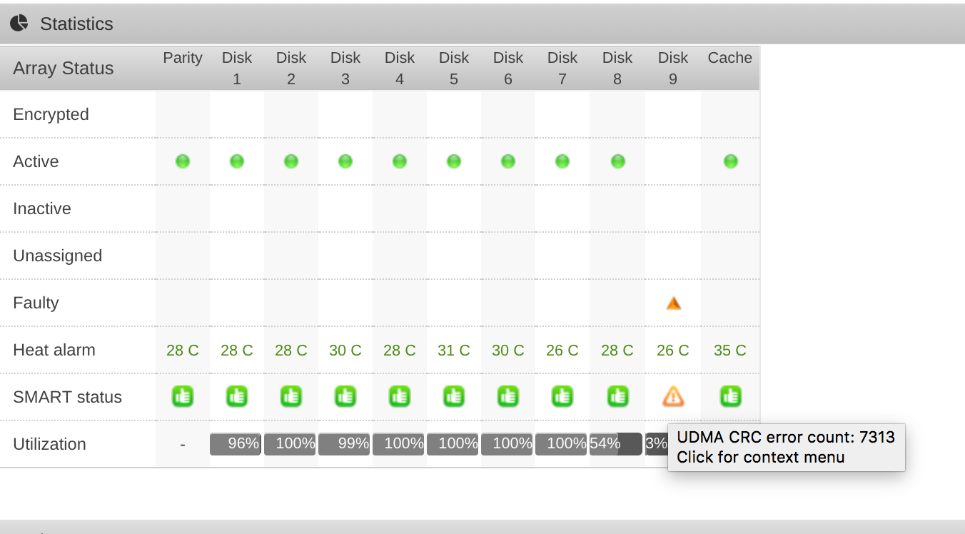

Alright, so I now replaced the cable and unraid is rebuilding the drive.
I still have that UDMA_CRC_Error_Count of 7313 on the S.M.A.R.T. report, and now unRaid does mention it is a faulty drive:
5a9830af11ca7_CloudAppAnnotation2018-03-01at11_55_58AM.png.thumb.png.7bb330c08aefc30da520ecb1ddfa797d.png
Should I just acknowledge the error?
Yes, CRC errors don't reset, as long as it doens't keep increasing problem is solved.
quick question: if I acknowledge the current error, if that value increases in the future, will I get another alert or will it be silenced?
yes
"yes" I will get another alert?
yes
Thank you :)
