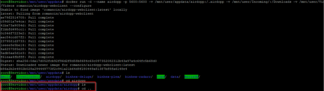

Why airdcpp directory is empty after download and pull the docker?
Thanks... (I'm a noob with docker system and i'm trying to install a docker that doesn't exists in CA.
PS: I am installing manually
