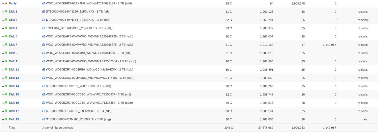

Parity Check Ultra Slow
Almost 40 hours into a parity check with a 17% completion.  Is there something I can post to get an answer on the reason this is so slow? Is it drive sdc that's the issue?
reiserfs?  Where's Disk 5, 8, 10, 18?
But, yes, looks like Disk 7 is having a bit of a wobbler.
Please post your diagnostics: Tools -> Diagnostics
Diagnostics attached.  Unbelievably I have lost Disk 5, 8, 10, 18 due to failure.  I have saved a good portion through dd to ud devices. I intend to read new drives to these slots after parity complete.  But I may be in a retirement home when that happens.
tower-diagnostics-20180329-1339.zip
Can I continue with parity and then swap out 7 or remove it and go again?
There's no point, parity would be mostly corrupt, you should remove that disk and re-sync parity without it, then try and salvage some data from it if necessary.
P.S. disk3 is also on the list of failing disks, and will likely also have read errors during a sync.
