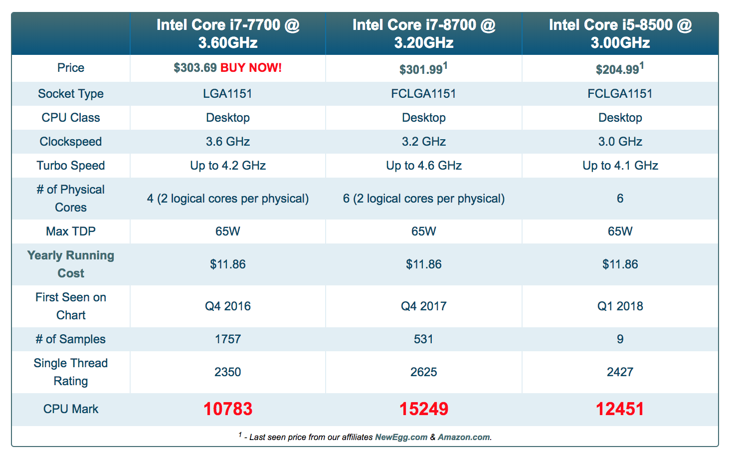

Still looking into this build and someone recommended getting one of the new Coffee Lake chips. So I found the 8700 but as Coffee Lake is Hex-Core I thoughts i'd compare it to the 8500 i5. Looking at the comparison below it looks like it fares reasonably well.
Would the 8500 be suitable for my usecase above? What do you all think?

I can see no reason to think that it would not be up to doing what you are looking at.  Especially since you are looking at using the WIN10 VM from the standpoint of an evaluation tool.  That VM should be able to do most normal computing jobs without breaking a sweat.  It gets a bit more dicey when one is looking to play high end video games or heavy-duty video editing.
While, I am not an expert in the use of VM's, you might be a little light on RAM.  32GB might be a better option point but only you know how serious you are about the using a VM.
