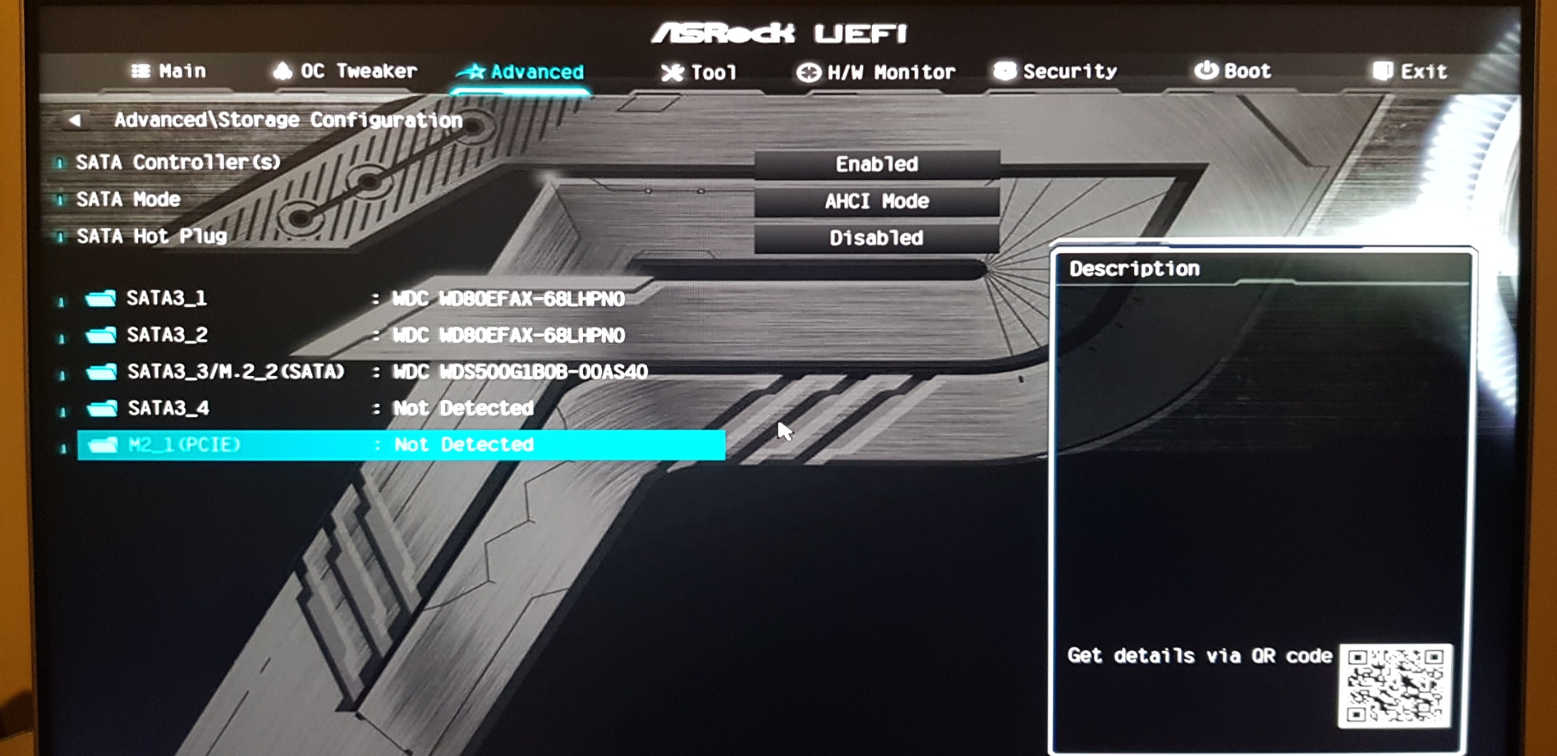

I've been putting together my NAS build for 6 or so months, and today I finished putting it together and decided to go with unRAID and have begun the install process.

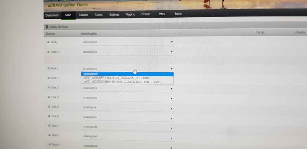

Unfortunately, I've been stuck for hours trying to recognise all my drives. I can only see one of my two 8 TB WD Red drives, despite the fact that they are both visible in BIOS (please see attached images).

The first disk is detected just fine. The second one is seen briefly and then lost. The SATA port is reset to a slower speed and then disabled. The fault is either the port, the cable or the drive electronics. Change the SATA cable (again) and check the power to the disk (again).

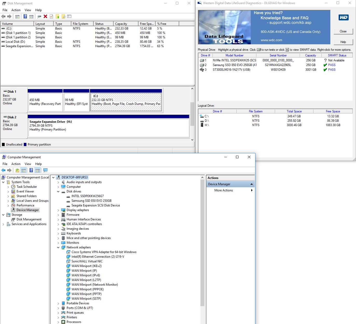

I've connected it to my main workstation, and it doesn't even recognise in the BIOS or within Windows (I was going to run WD LifeGuard). So I've tried a whole bunch of SATA cables, ports and power options now and it's a no go.
Probably DOA and nothing to do with unRAID.

The disk might have been dropped and damaged or zapped by static. Sounds like you need to get it replaced. Good luck!
