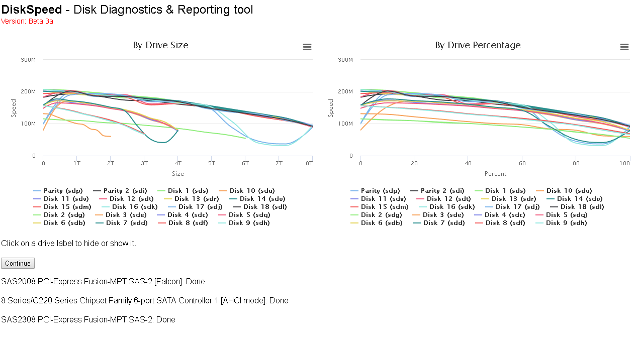

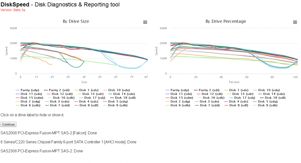

Extra activity stopped, but if there's no speed improvement that wasn't the problem, there's no disk related errors on the logs, run diskspeed on all disks to see if speeds are normal.
OK, ran to completion the second time. Results are attached. Your help is greatly appreciated!!
