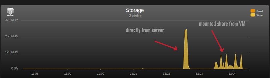

I have the same problem. While the VM is working fine, any mounted shares from the array (could be nfs, sshfs or p9) are kind of capped at 35Mb/s. A test disk on that share from the server is totally fine (166Mb/s).
Did you progress with that issue ? Any clue of what's happening ?
