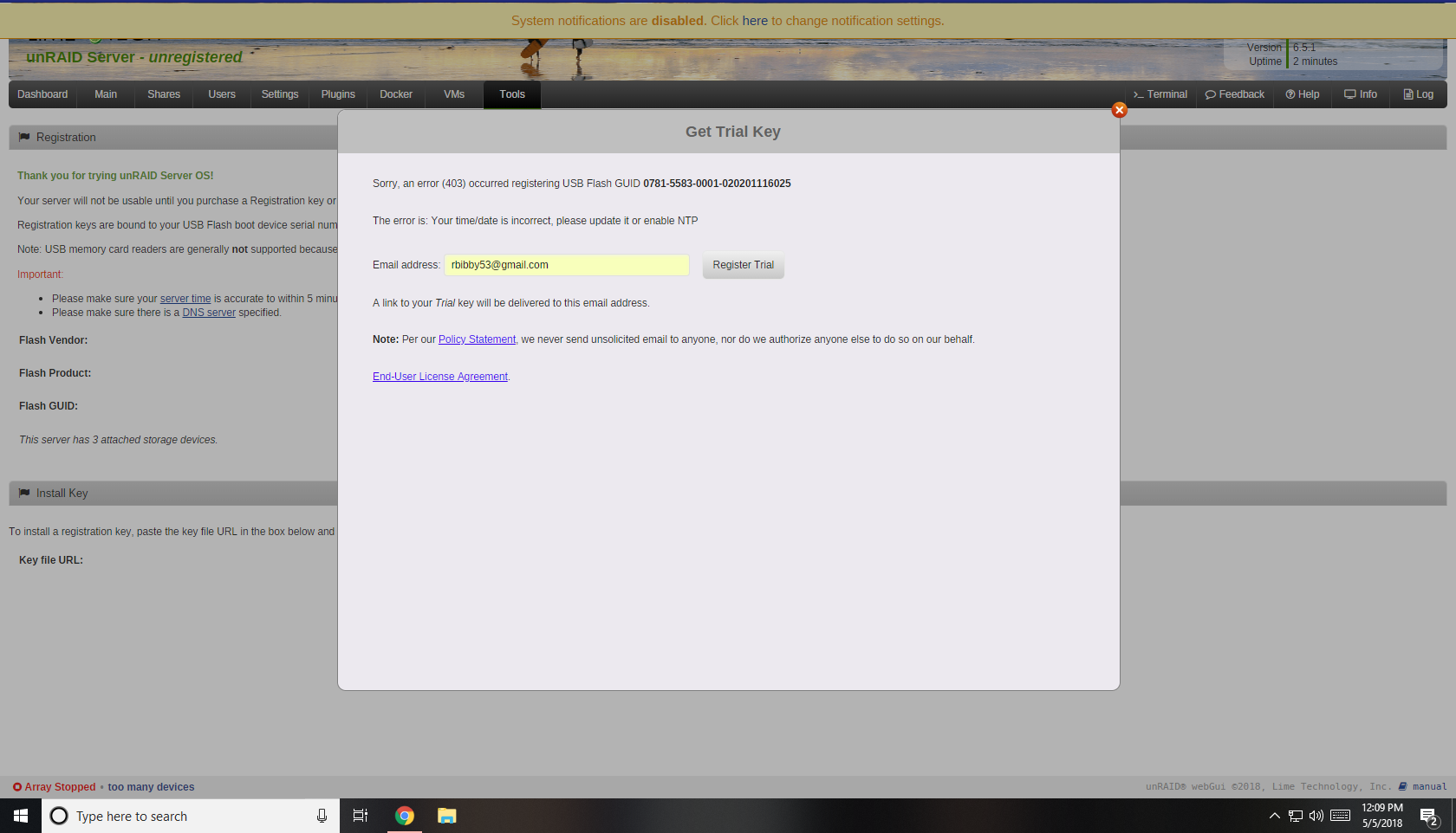

It keeps giving me the same error code, saying the time is incorrect. But the time is correct. What should I do?

From the error logs on our side it's showing your time is off by 12 hours

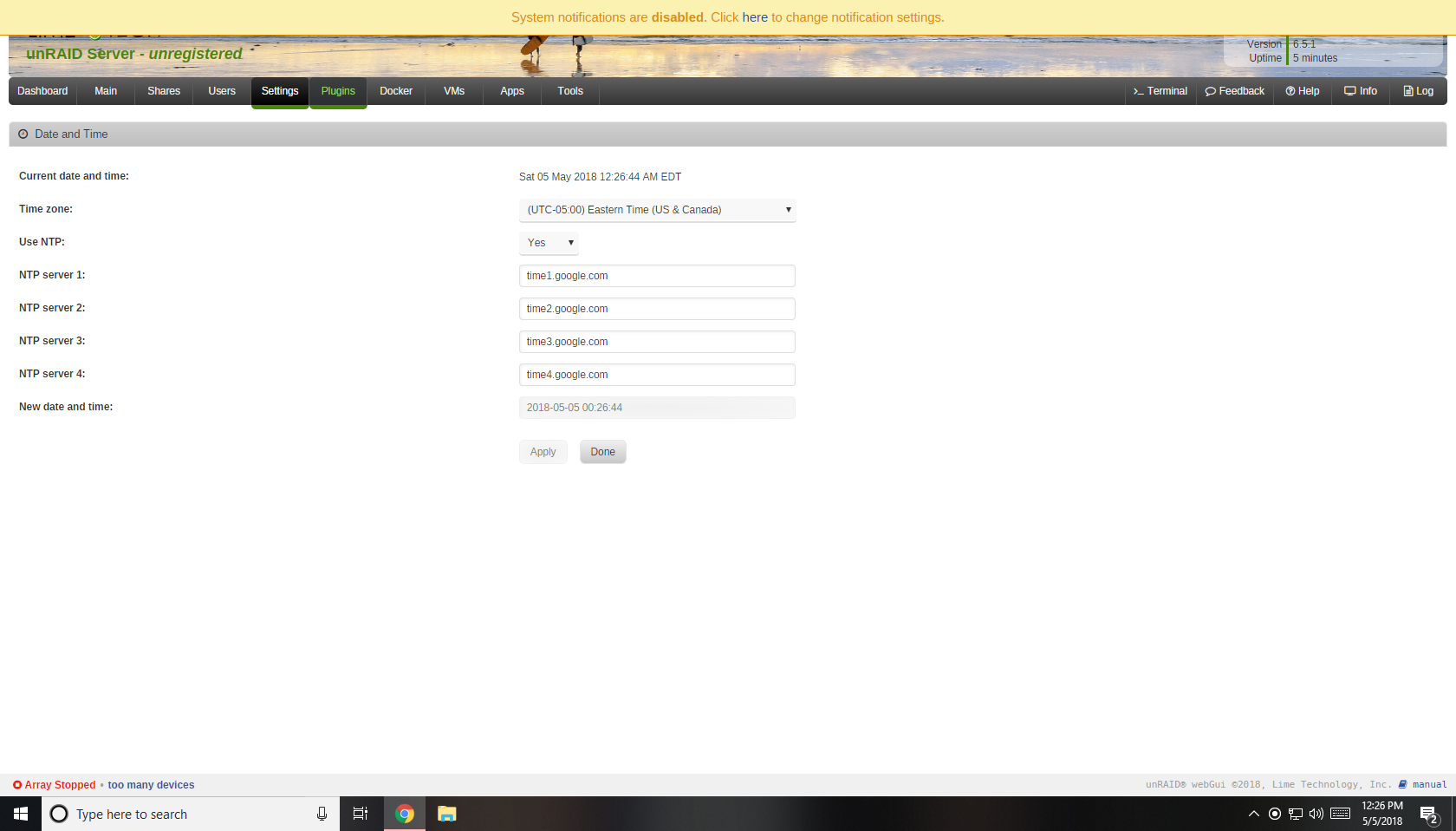

What should I have my time zone set to? I live in the eastern time zone
Looks like it should be PM instead of AM... so maybe NTP isn't working for some reason (but I don't see why from the log file you attached).
Try this:
1) Change 'Use NTP' to No
2) In the 'New Date and time' field, change '00' to '12'
3) Hit Apply
4) Try to register for a Trial key again
5) some time later: Change 'Use NTP' to Yes and hit Apply
