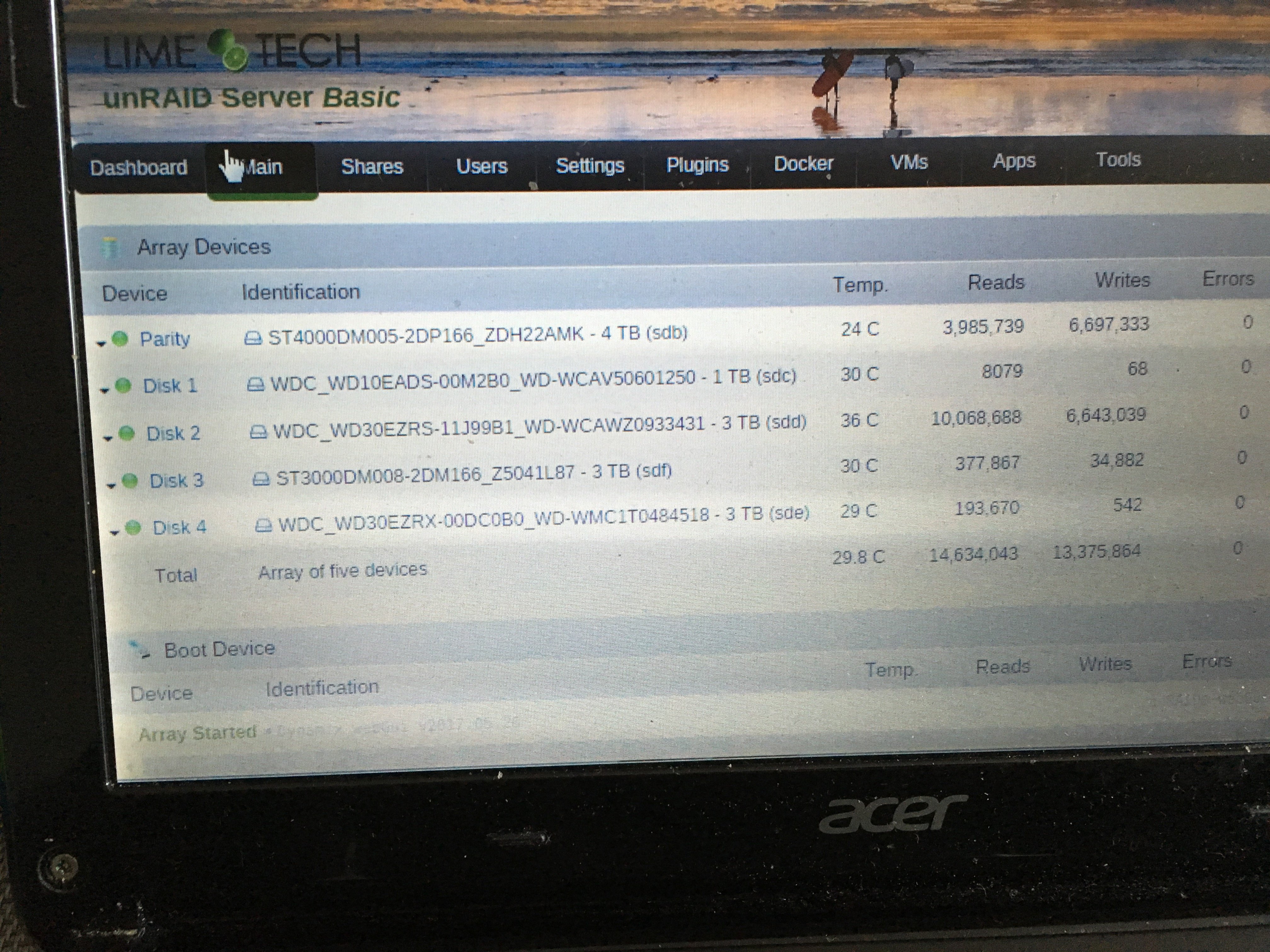

Heres were I almost messed up.When I go to add my drives to the array I notice its pulling up the wrong drives. I change them to the correct ones( I had taken a screenshot before I swapped the cases). I remember I had removed some drives and replaced them with new ones. Luckily, unraid said there were to many errors and would not let me start the array.
My question is,should I just download a fresh copy and assign all my drives in the same order as my screen shot?

Just do a new config (Tools -> New config), reassign all disks, double check all assignments are correct and check "parity is already valid" before starting the array.
