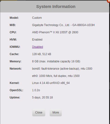

Here is the diag and screenshot of system specs from unraid info.

53 minutes ago, AJ Ouellet said:
I'd have to open the box to find out what PSU i'm running but I think it was a thermaltake 800w.
mediaserver-smart-20180527-1617.zip
No, that is not the diagnostics. It is just SMART for a single disk.
