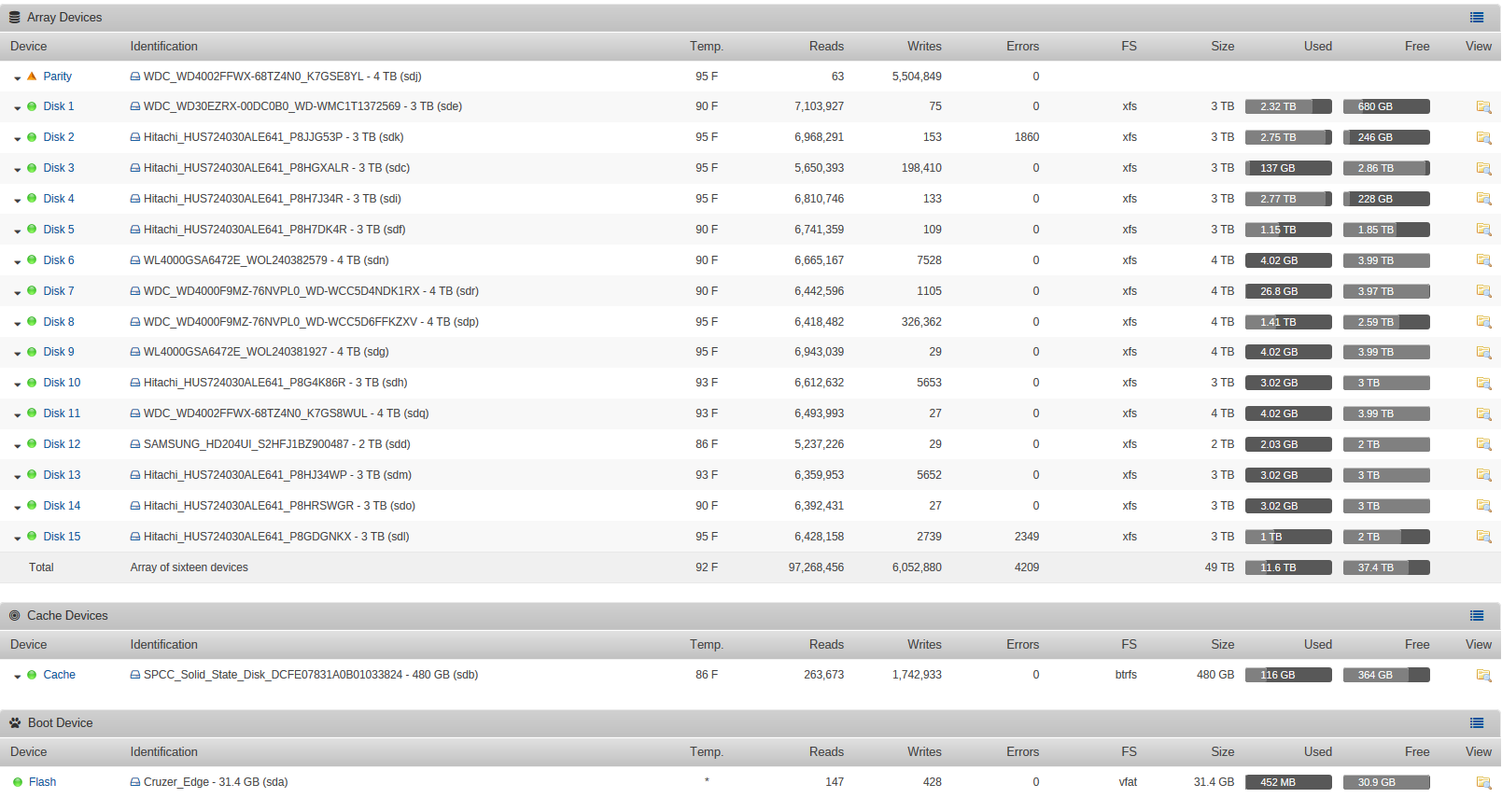

I have a 3U supermicro system running 2X X5650 Xeons. I have 17 disks total and on at least 3 of them I am getting UDMA_CRC errors pretty frequently. Drives are running from 2X LSI 9211-81 in IT Mode through a Supermicro direct attach backplane. I have already replaced the cables from the HBA to the backplane and things have improved. I have been fighting this for a few weeks now with drives dropping out of the array etc.. I was finally able to get all drives added back into the array after the cable swap, but I am still seeing 3 drives producing UDMA_CRC errors. I have a new backplane on order and plan to switch that out. I am running a 920-SQ power supply (supermicro)
My question is, can the HBA be causing this, and if so, wouldnt it affect all drives, or do you think this is something in the backplane, I have swapped cables twice now, first set cheap from amazon caused more problems than i had originally, so ordered some better quality ones.

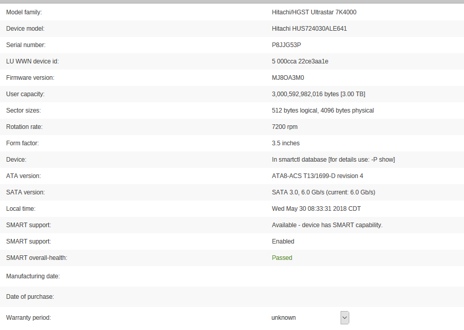

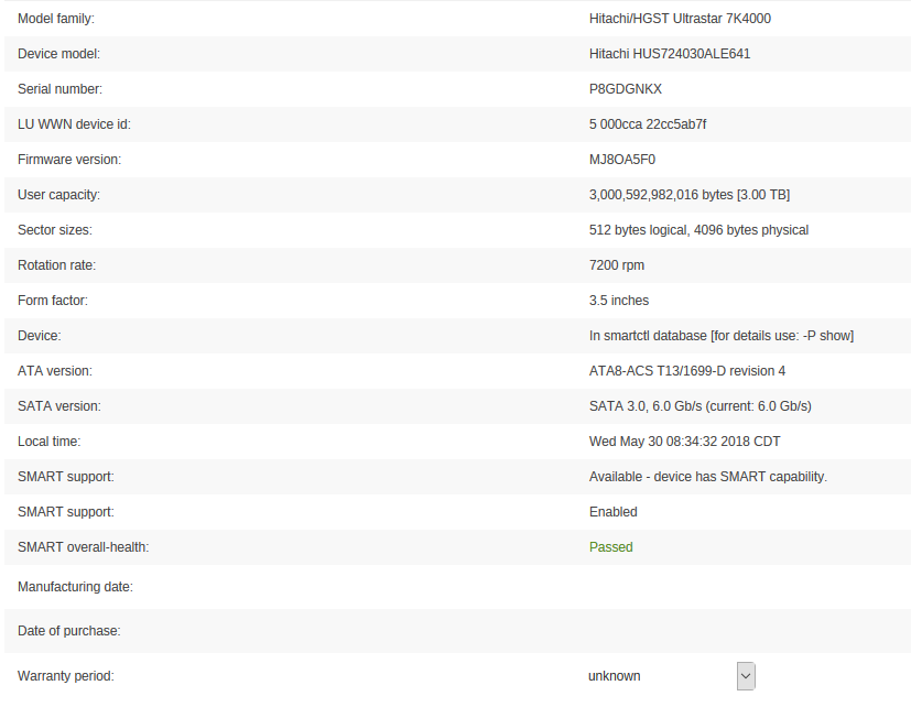

In the screenshot, it shows errors on 2 drives, but smart test says theyre ok.
Any advice on where to look next? Is replacing the backplane a valid idea?
Those are read errors, possibly related to connections issues, but parity sync will have some corruption.
I would say the backplane is more likely the culprit, you could swap cables and disks on the affected slots and see if the CRC errors stay with the slots.

Do you think the read errors are related to the parity sync?
Related as they happened during the sync, but not caused by it, like I said parity won't be 100% valid with those errors, diagnostics might give some more clues.

SMART for both disks looks fine, and both have a very high number of CRC errors, so more likely connection related.
You can let the sync finish but you'll need to do a correcting parity check after to fix those sync errors.
