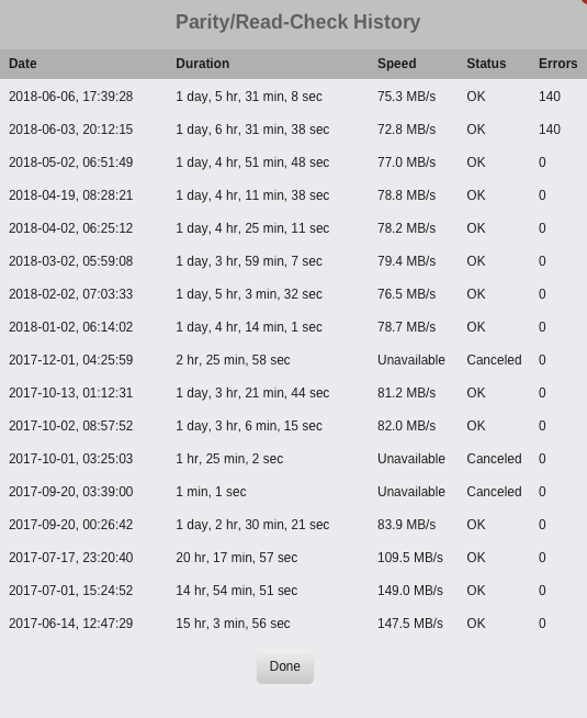

i grab the diagnostics if that helps.
i also reboot it and start stop the array
in the past i also had problems with HPA, if this helps a little bit.
im starting to worry...
Any help would be greatly appreciated!
diagnostics-20180606-2235.zip

When? I don't see a parity sync in the log. You need to unassign parity, start the array, stop the array, re-assign parity and start the array to begin parity sync.
thanks!
i just did the above steps and i start parity sync.
