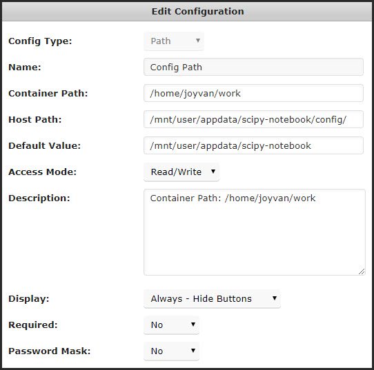

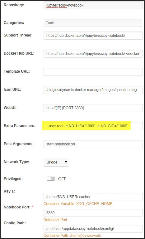

I'm trying to mount a local unRAID appdata folder to the working folder in docker container jupyter/scipy-notebook. The container runs and works fine except my work is not being saved to my volume mount. I believe the problem has to do with incorrect values in the "Extra Parameters" section for the User Id and Group Id. I've tried 99 and 0 as values. Can anyone help me get this working? Your help is appreciated! Thanks!

My Configuration:

I figured it out. I assumed the default user in the container was jovyan so I didn't set it. After reading the docs again, I explicitly set the NB_USER and now it works.
Extra Parameters:
--user root -e NB_USER="jovyan" -e NB_UID="1000" -e NB_GID="100"
