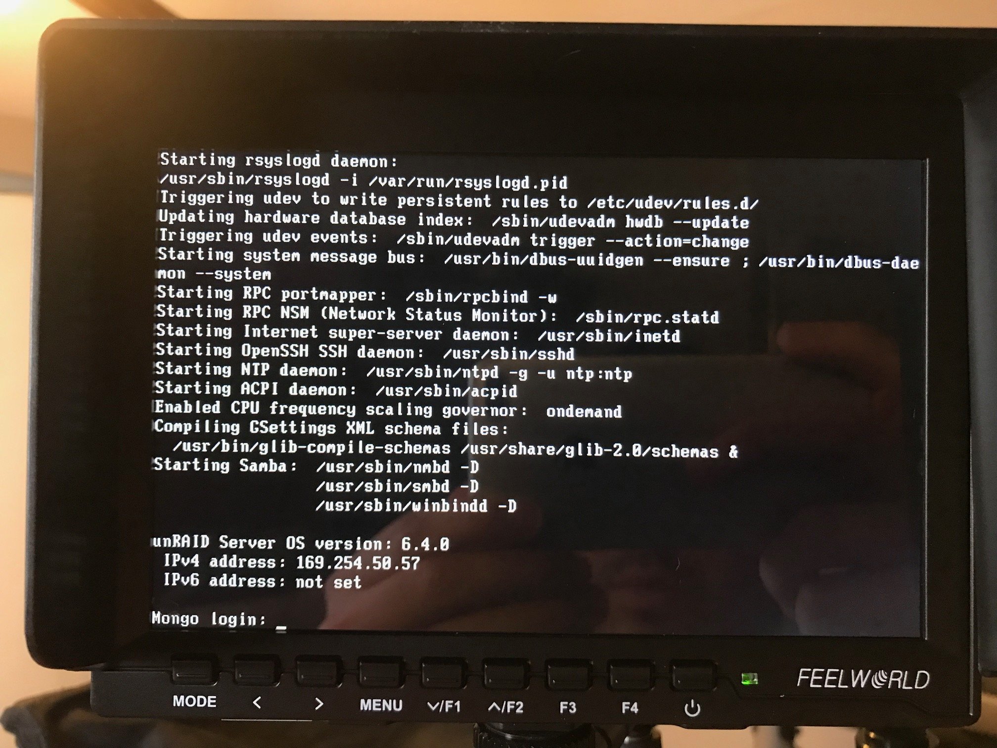

I was away for a week an noticed that my Plex server was no longer available. So I logged into my desktop remotely to try to reboot Plex on my unraid 6.4 box. But my unraid server wasn't accessible by normal means.
It appears to be booting normally (see image), but I still can't access it from a network computer. It's hardwired into my modem/router and the connection in the router setting appears solid. But the unraid server isn't showing up as an active device in the device table.
I can't think of anything that has changed since the last time it was all working.
Any ideas?
That image shows the unRAID server is not getting an IP address from your router.   There has to be some sort of network related issue for that to be the case.
Thanks itimpi, that got me pointed in the right direction. It doesn't appear to be an unraid problem at all. Just did a hard reset of the modem/router combo and it appears to have fixed itself.
