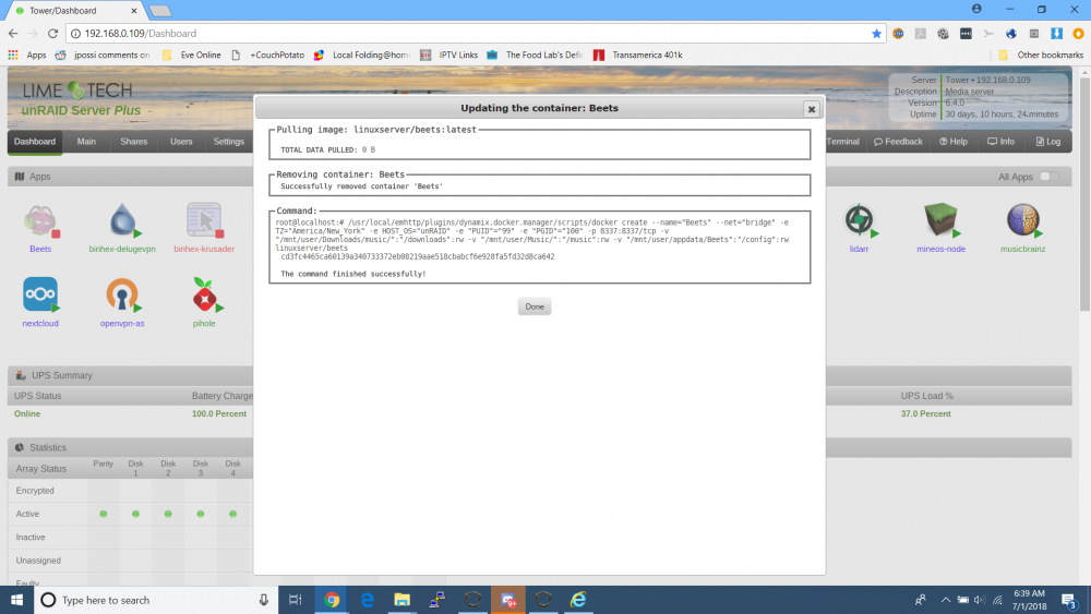

July 1, 20188 yr Hi folks, been having this problem for a while now. Dockers indicate an update is available but when I try to install the update it downloads 0 bytes. This happens on with all dockers. If I reboot the server then everything seems to work fine for a month of so but I'm not a fan of un-necessary restarts. Any idea what might be causing this? tower-diagnostics-20180701-0642.zip

July 1, 20188 yr Author Thanks. All the containers showing an available update are Lsio. Should they change to 'green' after attempting the update if no new images are available? These are staying 'blue'.
