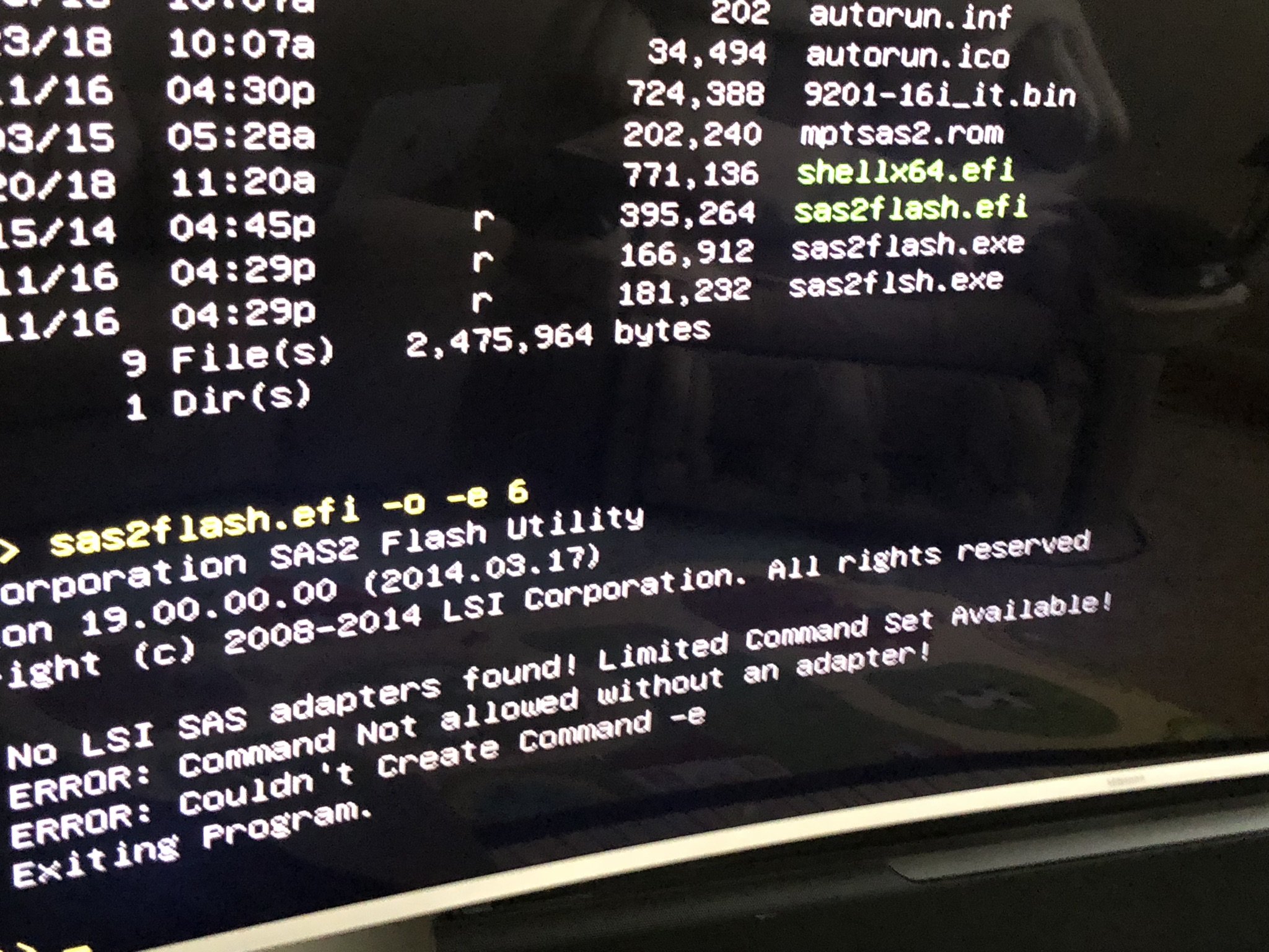

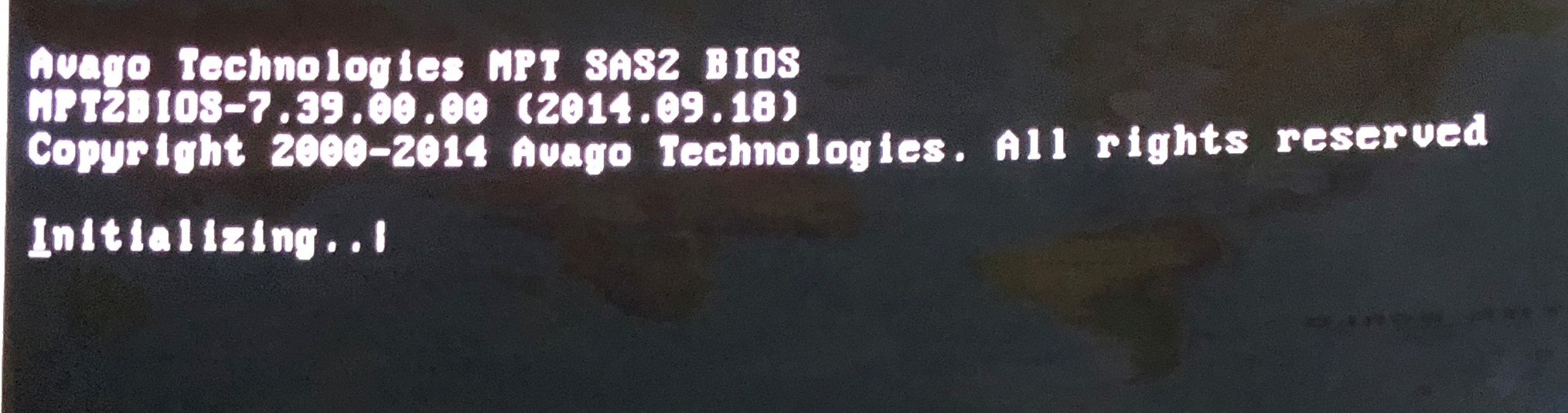

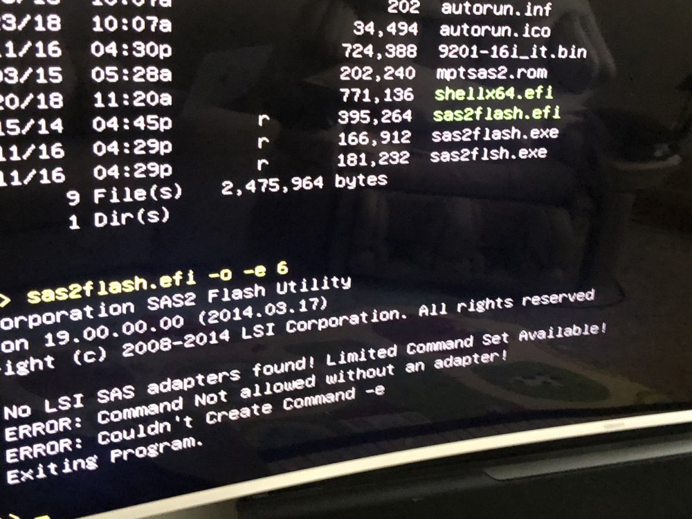

July 26, 20188 yr Hi everyone I just finished building a server and I have an issue with my HBA card. I am using Windows for now but will be installing Unraid soon. I am using an LSI 9201-16i with an Asrock Fatal1ty X399 mobo and 1950x CPU. When I boot the computer the HBA card boot screen shows up first and then stays stuck on "Initializing". I can't use "Ctrl-C" to check which mode it is on. I tried to flash it through a DOS prompt and couldnt get it to work. I then booted in UEFI and tried again and the EFI SAS utility tells me it cant find the card. I tried two different cards and got the same result. The second I even made sure to buy from someone who had flashed it to IT mode and had been using it in a Freenas server. And when I do mange to boot into Windows the card is seen in the device manager. So I dont think its something to do with the card but probable with my config (bios options maybe?) If anyone has ideas or suggestions that would be great. Thanks!
July 26, 20188 yr In BIOS, you may turn-off the legacy storage booting, then storage opt-ROM won't load. Or you may try destory the firmware of LSI controller. ( I haven't try that ) Edited July 26, 20188 yr by Benson

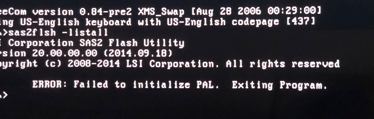

July 27, 20188 yr Author I'm not making any progress. I tried the DOS boot and I get a "Failed to initialize PAL" error (apparently this is common on motherboards that have a UEFI mode). In UEFI mode it says the SAS adapter is not found. And in regular boot it just stays stuck on "initializing" like before. The weirdest thing is that I tried two different LSI cards, one of which is guaranteed to be already flashed in IT mode and I get the same result. Wonder if there's something wrong with my motherboard o my Bios config.
July 27, 20188 yr Pls ref. below long long post. The problem should be your motherboard not compatible with LSI card. May be try mask the PCIe finger pin ...... or whatever No need to focus on flash IT/IR, it is booting issue. Anyway have you try turn-off "Legacy storage boot" ?? http://lime-technology.com/wiki/index.php/Crossflashing_Controllers#Important_Warning.21 If you receive a "Failed to initialize PAL" error while trying to flash the controller card, it is most likely due to your motherboard having limited option ROM. You will need to find another motherboard to use to flash the controller card. If your motherboard supports UEFI it will also work if you boot into UEFI shell and perform the necessary steps. See Boot drives
