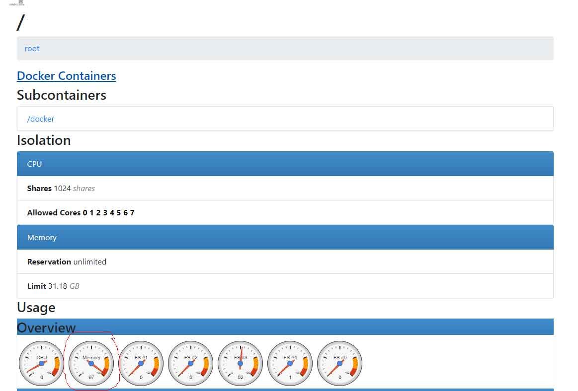

August 4, 20188 yr Hi all, I am having some weird issues which looks like its coming from my Docker Engine. The issue started about a week ago and comes across as these symptoms 1. Dockers seem unresponsive i.e. Emby Tvheadend etc.. 2. When I go to the Docker menu - They are all showing as running however when I try to goto their respective Webui they are not responsive 3. I Dont think stopping and Starting makes any difference Below are a set of steps I have tried 1. Delete Docker Img - re-create and add all containers back 2. Docker image is 30GB with 5GB being used 3. stopping and starting docker engine from command line via /etc/rc.d/rc.docker stop / start seems to restore things I have ran a diagnostic and I see these two errors come up int the Docker log file time="2018-08-02T06:17:24.90385105+10:00" level=info msg="stopping containerd after receiving terminated" time="2018-08-03T17:51:27.298044846+10:00" level=info msg="stopping containerd after receiving terminated" Any advice or thoughts to help troubleshoot would be ace!

August 5, 20188 yr Author Ok I have tried to see if there is a specific container causing this issue but cant seem to find it. The weird thing is that CA Advisor shows memory at 96% however when i run Docker stats The memory on each container is hardly being used. Any thoughts anyone? or what else to check for?
August 5, 20188 yr Since you're not in a specific container, cAdvisor is showing the total memory used on your system, including some caching. Getting the stats on a particular container will show the memory usage of it, exluding caching. Diagnostics (after doing whatever you do to get the symptoms in the OP) is always a plus when posting Edited August 5, 20188 yr by Squid
August 11, 20188 yr Author Ok Just a heads up on this I pretty sure it was my Unifi container causing issues after an update. I did however upgrade to 6.5.3 and everything works fine. I still need to try to diagnose the issues with the Unifi container
