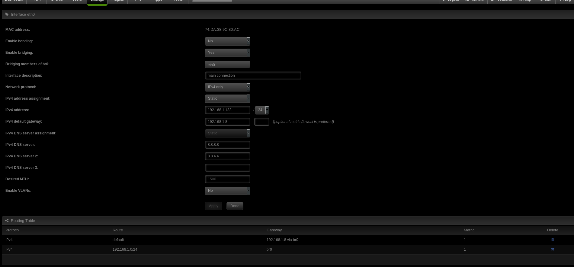

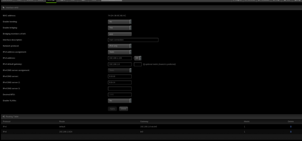

Unfortunately that still didn't fix the issue so its probably not the builtin nic. If anyone else has any ideas i am open to suggestions. Here is a screenshot of my network configuration and what happens when i turn on bridging.1301311294_Screenshotfrom2018-08-0817-53-12.thumb.png.01c2cd03e31b1947c5eec328b3b4a33b.png1370176044_Screenshotfrom2018-08-0817-52-42.png.02f47d65a9629543d8c6527996d60dff.png
Nothing stellar is really jumping out at me from your logs.  That said, I do notice you're using a Realtek NIC (may be built onto your motherboard).  Know that Realtek NICs are known to be problematic due to their poor driver support for Linux.  A simple fix might be to purchase an Intel-branded NIC and install that onto your system.  In addition, I have personally had many issues with Gigabyte-based motherboards and GPUs, so in the future, I'd recommend to stray away from that brand as well.
Hoping someone else in the community maybe has seen this problem before and can recommend an alternative solution but for now, but recommended fix would simply be to purchase an alternative NIC for this machine.
